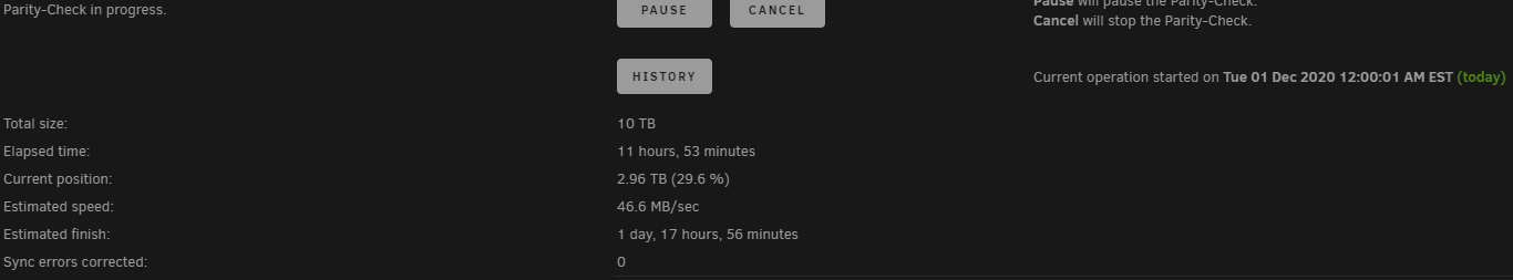

I'm curious if I can do anything to increase my performance, especially during parity checks.

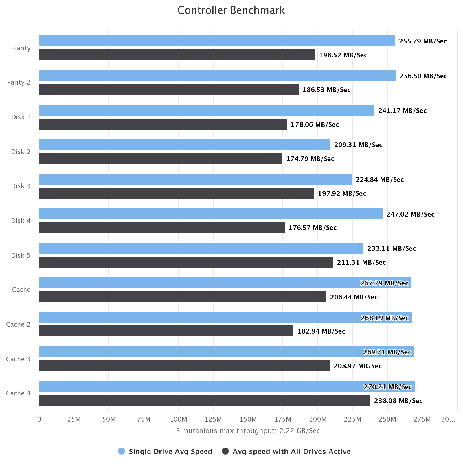

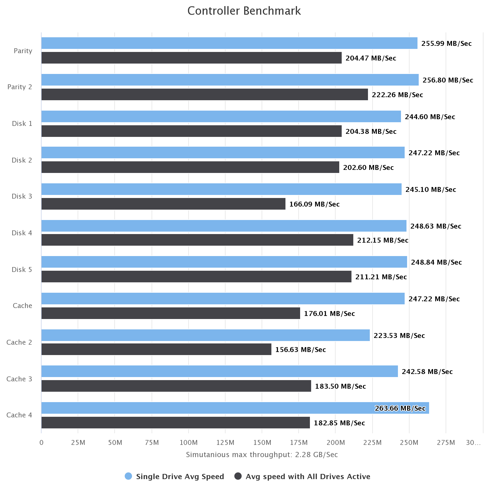

Run also the controller benchmark and post the results, make sure the screenshot shows the link speed.
SAS2008 PCI-Express Fusion-MPT SAS-2 [Falcon]
Broadcom / LSI
Serial Attached SCSI controller
Type: Onboard Controller
Current & Maximum Link Speed: 5GT/s width x8 (4 GB/s max throughput)
Capabilities: storage pm pciexpress vpd msi msix bus_master cap_list rom
While the controller is bottlenecking a little it's not the issue, please post diags during a parity check, make sure no other array activity is going on, there were some small writes to the array in the previous diags.

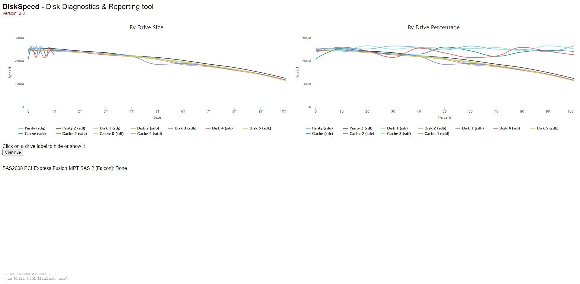

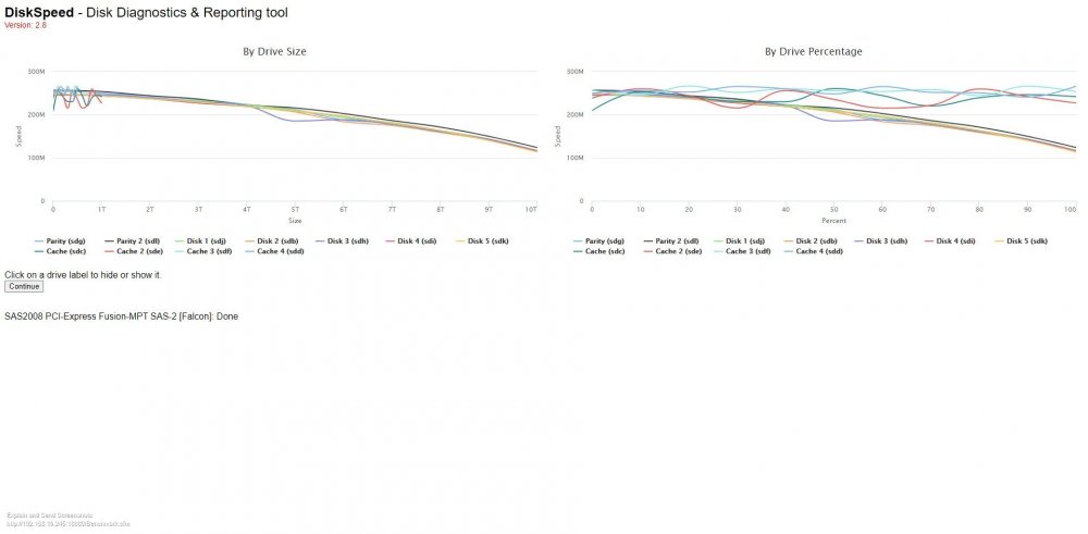

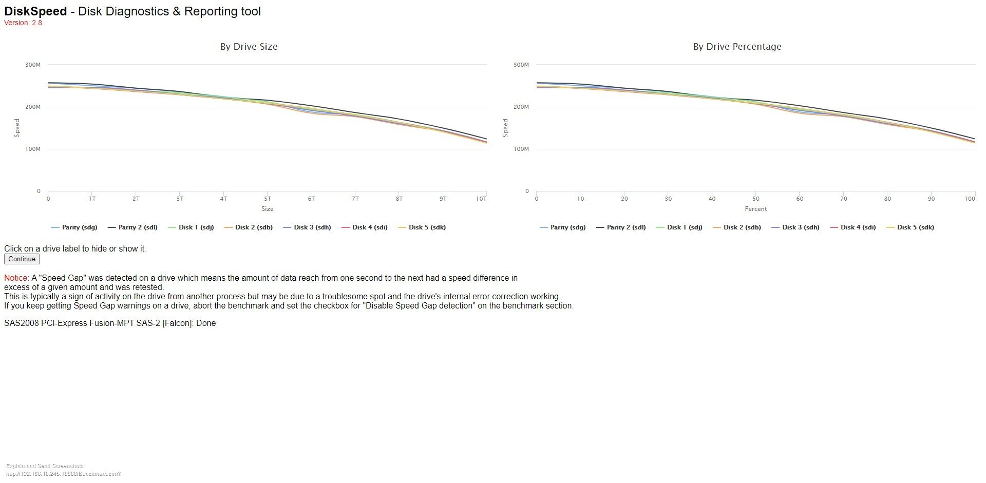

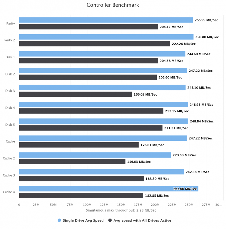

I stopped all of my VMs and all of my dockers.  I ran the diags and benchmarks while the system is completely idle.  I'm still trying to complete the benchmarks while parity is running, but I keep getting "speed gap" warnings and retries even though I checked the box to ignore speed gaps.
unraid-diagnostics-completely idle.zip
I was unable to complete the benchmarks on parity drive 2, so I canceled the parity check.
Why? That won't give accurate results.
