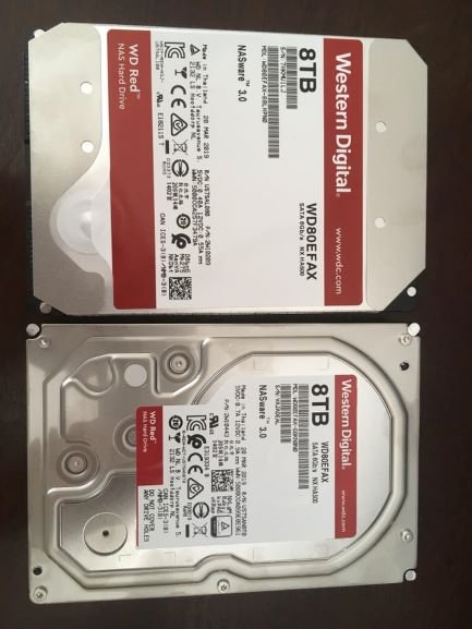

Yep, models are not consistent, you can also tell by the casing, top is helium, bottom is air:
or by looking at SMART, helium drives have this extra attribute:
ID# ATTRIBUTE_NAME          FLAGS    VALUE WORST THRESH FAIL RAW_VALUE
 22 Helium_Level            PO---K   100   100   025    -    100
