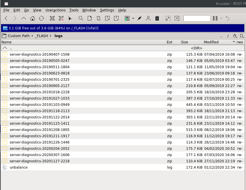

I was really trying to not create a new topic just for this, but I could not find a solution: my understanding is that when I setup syslog to mirror to flash the logs should be going to the /logs/ folder on flash. Unless I have the wrong location it should be this /boot/logs/. I have Krusader set up to map a path variable to this location, and I see historical logs there in zip files, but nothing recent enough.
I am trying to troubleshoot a freezing issue with my server that has been plaguing me for the last couple of weeks, so I also set up remote logging since i couldnt track down logs on the flash.
Below is how I configured the syslog options
Here is what is available in /boot/logs/
This is how I mapped the path in Krusader, if that helps.
server was stable for a good 5 or so days, but then just crashed again. I dont see any new logs on the flash, and of course the logs get flushed when the server comes back up.
im not sure what im missing. any thoughts?
