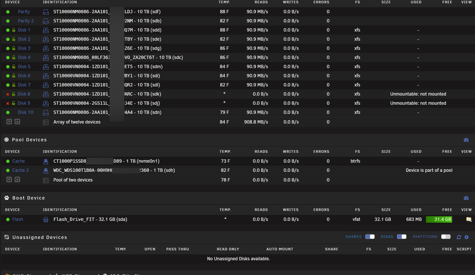

I started yesterday with 10 Seagate 10 TB EXOS drives running in my array. 2 Cache drives, 1 as parity. I got 2 new EXOS 10 TB drives. *Cache drives are a NVME and SSD.
I added the new EXOS drives into my array. I created a new config to do so. Things seemed to be running 'ok' with parity being checked / rebuilt. (I think?) Anyway, this morning I have 2 drives showing unmountable and one of my cache drives showing as missing. Ugggh. I rebooted and things came up ok...except two drives showing unmountable.  I have brand new high quality SATA cables and nothing is pinched or otherwise in a weird configuration.
What can I do from here? Pretty sure the 2nd parity drive is worth nothing here since it wasn't done building and I believe 2 drives down is no-Bueno.

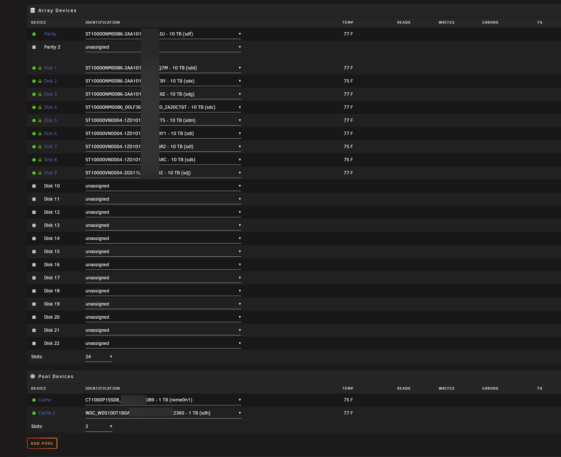

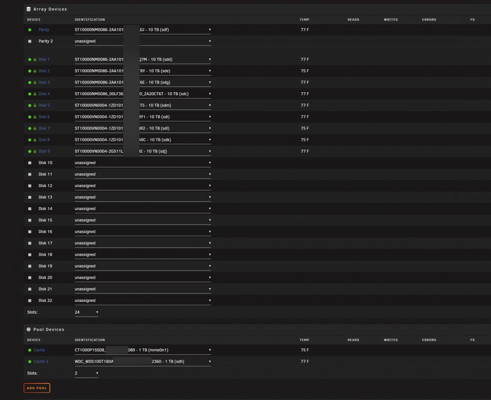

I created a new config, but I added the existing disks back in the same exact order they were in.  I then added 1 new EXOS drive to the 2nd parity slot and the other EXOS drive to a new slot.  I forgot to mark the new data drive as encrypted (as my other drives), but I think that is unrelated. (?)
So the disabled and unmountable disks ARE NOT these NEW disks?
No, those appear to be mounting without issue.
Before-
After-
Of course, technically neither parity disk is mounted since they have no filesystem.
