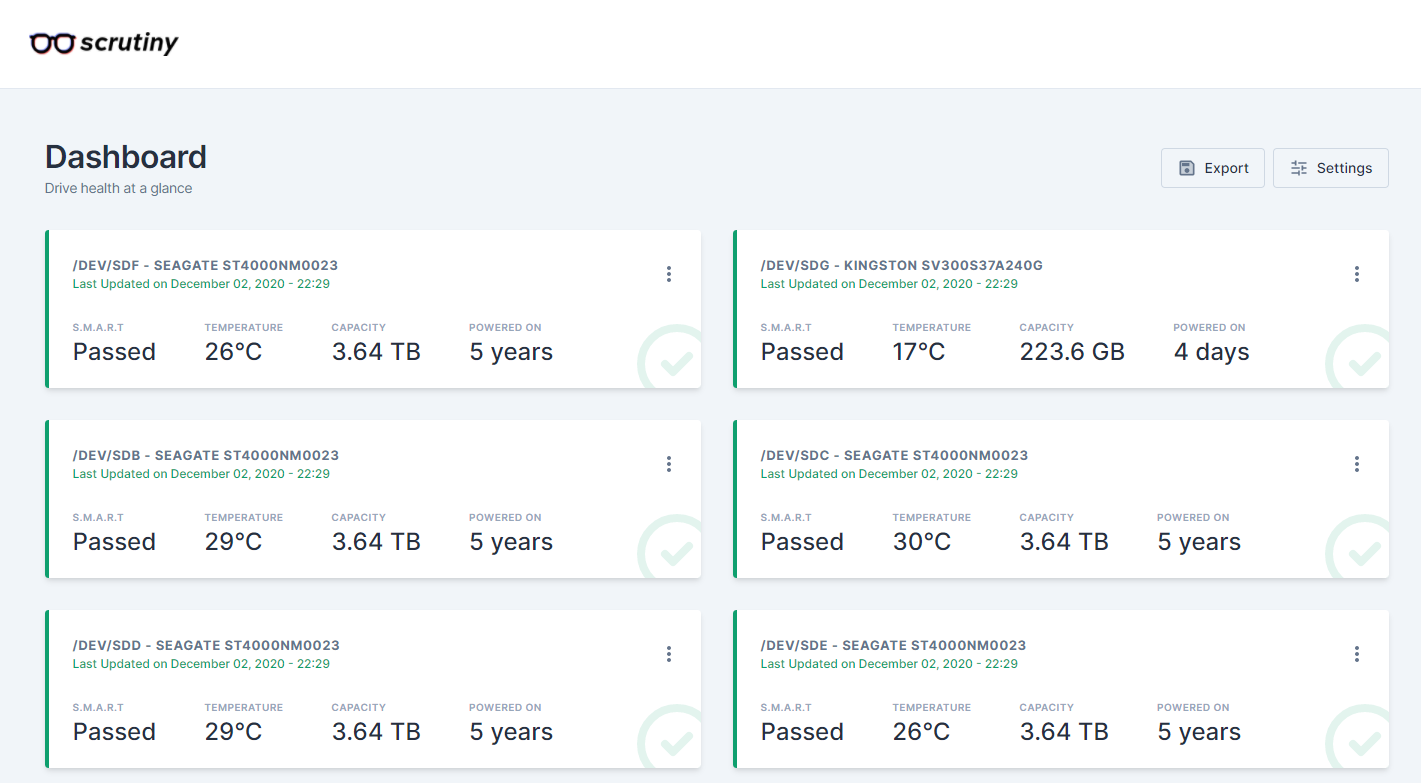

**************** EDIT ******************
scrutiny analyzes all disks without problem
