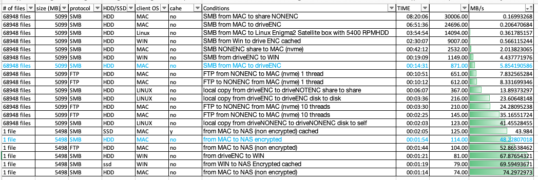

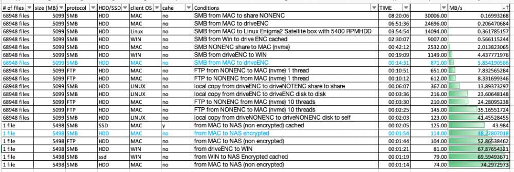

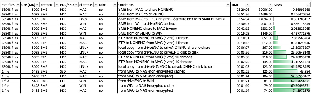

i did a series of tests. the server is a HP Microserver Turion N40L. I was running windows server on it for years but never had such issues with SMB shares like i have with Unraid. Encryption does not seem to have much effect here. It has performance trouble even when copying between internal drives.
Also the stats showing throughputs on the network side seem to show big BS while it is copying over files.
on MAC some serious throttling occurs
and windows has some ups/downs too
I am curious to see if i upgrade the hardware for some SATA3 mainboard and better CPU if i get better results with unraid or if i boot xpenology if i get the same results on the same hardware. Will keep you posted but there are tons of people complaining about SMB performance on Macs but most of them are treatable on the server side.
Anyway could someone please explain me the meaning of SSD cache drive existance if the parity drive is HDD?Is the parity being written when i write to the cache or not? Coz when i run timemachine i can hear the parity drive going nuts so i wonder if it is the reading due to the time machine or some uncontrolled writing. Anyway using SSD cache or no SSD cache does not make a difference on a Timemachine backup performance.
Anyway using an unraid SMB share for accessing photos is a real PITA as the photos being 1.5 MB in size are basically not browsable as it takes minutes just to list the directory where the photos are and previewing them with finder takes many seconds too. And yes i have disabled the previews genration in finder and the .DS_STORE file generation on SMB client. Finder just does not get the data while the unraid appliance goes nuts just by visiting the folder with photos probably finder generating the thumbnails
Edited by theruck
the blue ones are Xpenology on the same hardware.
with small files it looks the synology software is 30times faster while on big files it is comparable though there is one great result i measured when copying from Mac to unraid on HDD i cannot explain

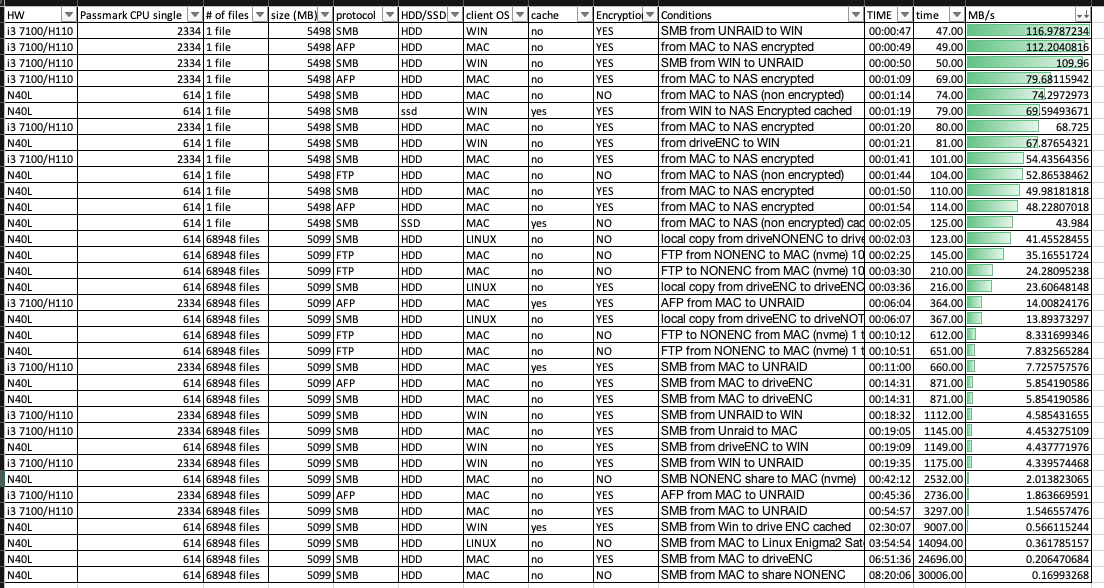

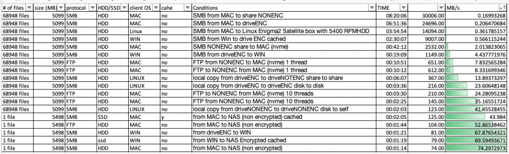

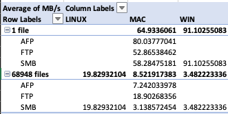

so i have upgraded the hardware of my server and did some new tests. some interesting data came out. check it out.
source table
comparing operating system - the Linux means unraid server itself disk to disk copy
conclusion: AFP protocol performs much better than SMB protocol on a MAC. And yes i did all the recomended tweaks on MAC side.
comparing throughputs when cache was used vs cache is not used
conclusion: enabling the cache on your shares has negative performance effect on my writing speeds note: encryption is used and the parity disk is HDD not SSD.
comparing CPU performance impact
conclusion: the better CPU had positive efect on both AFP and SMB performance with large file while it has negative effect on thousands of small files (strange)
comparing: OS
conclusion: the best performing client OS for SMB is Windows, on MAC AFP is the winner. For many small files FTP is the best option (the linux is the local copy)
CPU impact on drive encryption
conclusion: not sure if the perofrmance is due to the encryption or the fact that the higher spec CPU is able to better saturate the NIC

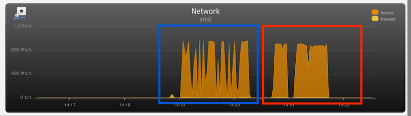

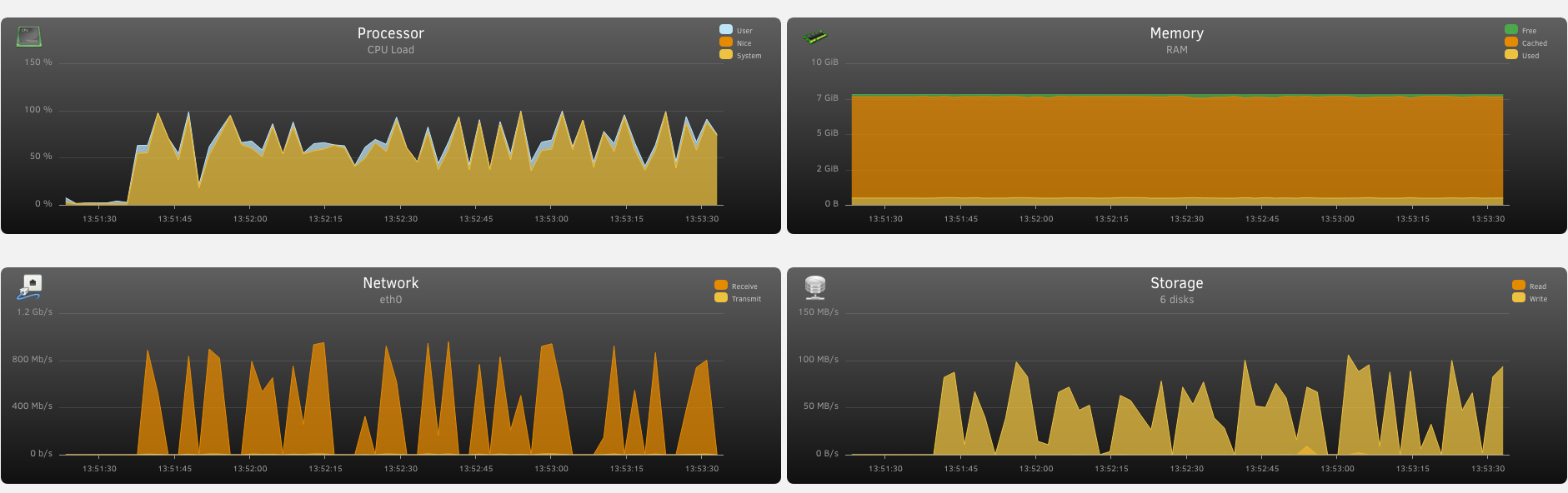

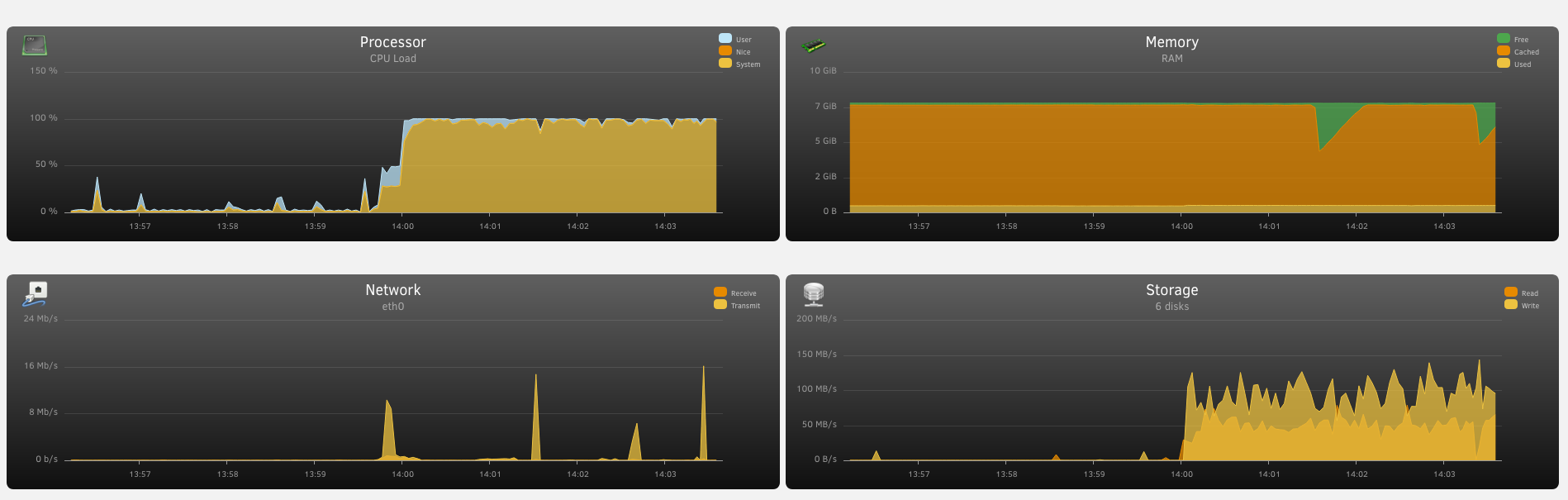

Network saturation during 1 big file copy
blue is SMB
red is AFP - 37% faster
