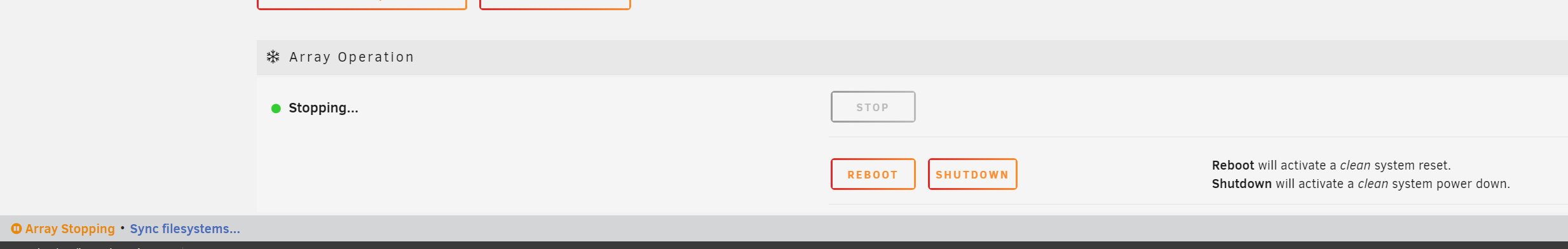

Stuck on 'Array Stopping •Sync filesystems...'
On disk2 of my array i have two directorys. If i try to list them with 'ls', the shell get stuck.
But, if i create a new directory on disk2, i can list it like normal.
So, i wanted to stop the array and reboot. [windowsuser, new to linux, try unraid since a week]
But now the Array won't stop also, it hangs on  'Array Stopping •Sync filesystems...'.

What can i do ? My unraid ist stuck in state "stopping" and i can't access the files in two directorys on disk 2.

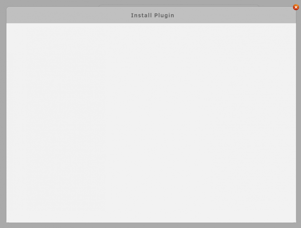

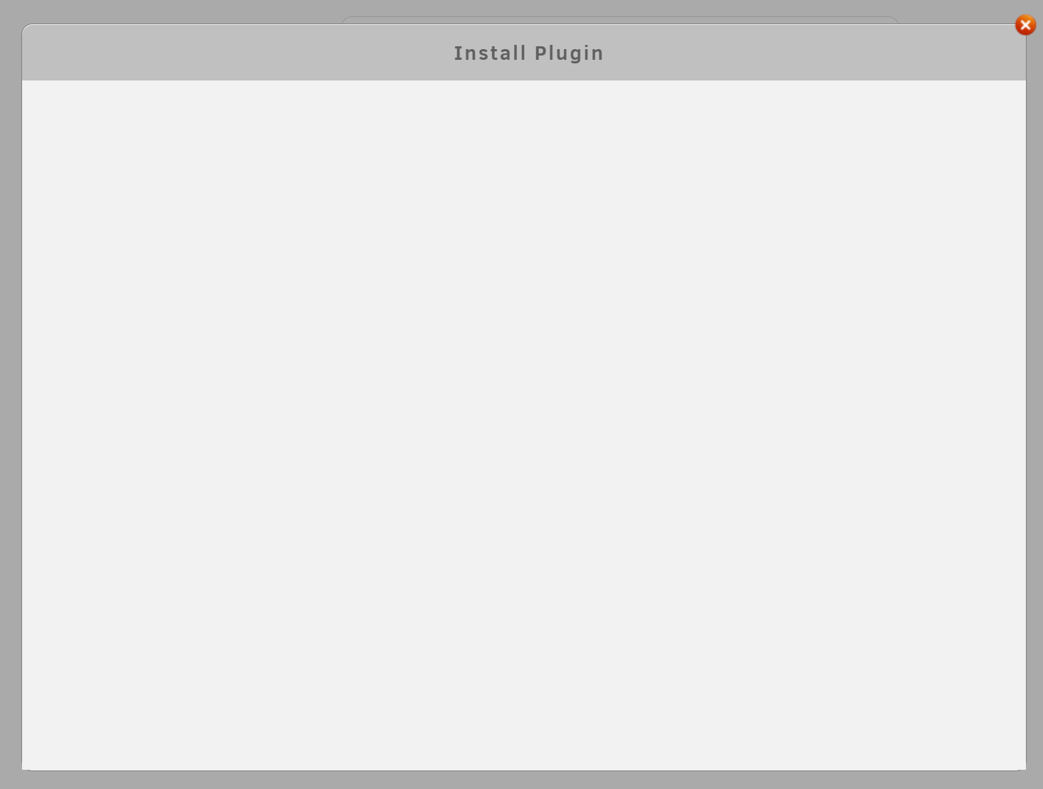

This "Stop shell" plugin sounds great, but it looks like i can't install plugins anymore.
The installation hangs, as seen in the picture.
