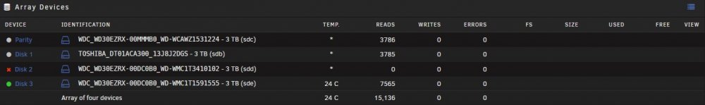

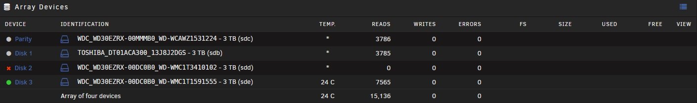

I have a 9TB array: 1 x 3TB parity and 3 x 3TB drives (screen: 'Array_drives').
I took the array offline and remounted in maintenance mode and am currently running Read-check which is 4.1% complete. I also have the extended SMART check running on both drives.

Issues with multiple disks, check/replace cables on disks 2 and 3 then post new diags (after array start in normal mode).
On it.
No back up cables so I'll order replacements and report back when I have new diags.

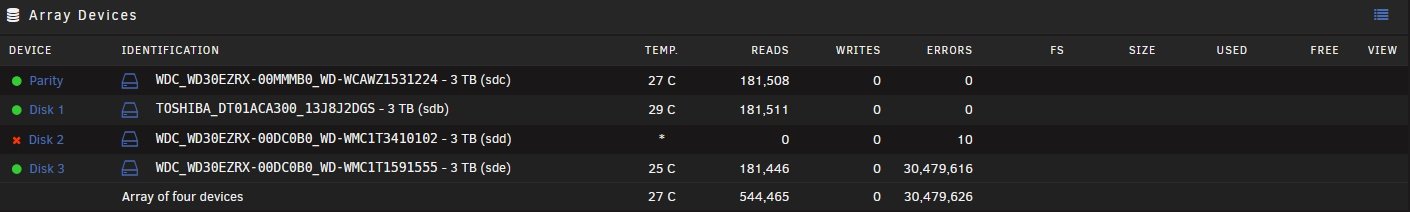

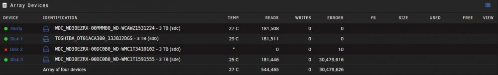

Cables replaced on disk 2 and 3!
Issues with disk 3 now appear to be resolved.
disk 2 is still being reported as "disabled", see screen below.
I am running the Extended SMART scan on disks 2 and 3.
What additional diagnostics should I run for disk 2?

Did some reading (oh oh) here, https://wiki.unraid.net/Troubleshooting#Re-enable_the_drive
All SMART tests have passed (took the liberty of doing parity and Disk 1).
- Reallocated_Sector_Ct, Current_Pending_Sector, and UDMA_CRC_Error_Count Raw_Values are '0'
So, I've followed the safe instructions to rebuild the array and am waiting for the process to complete.
