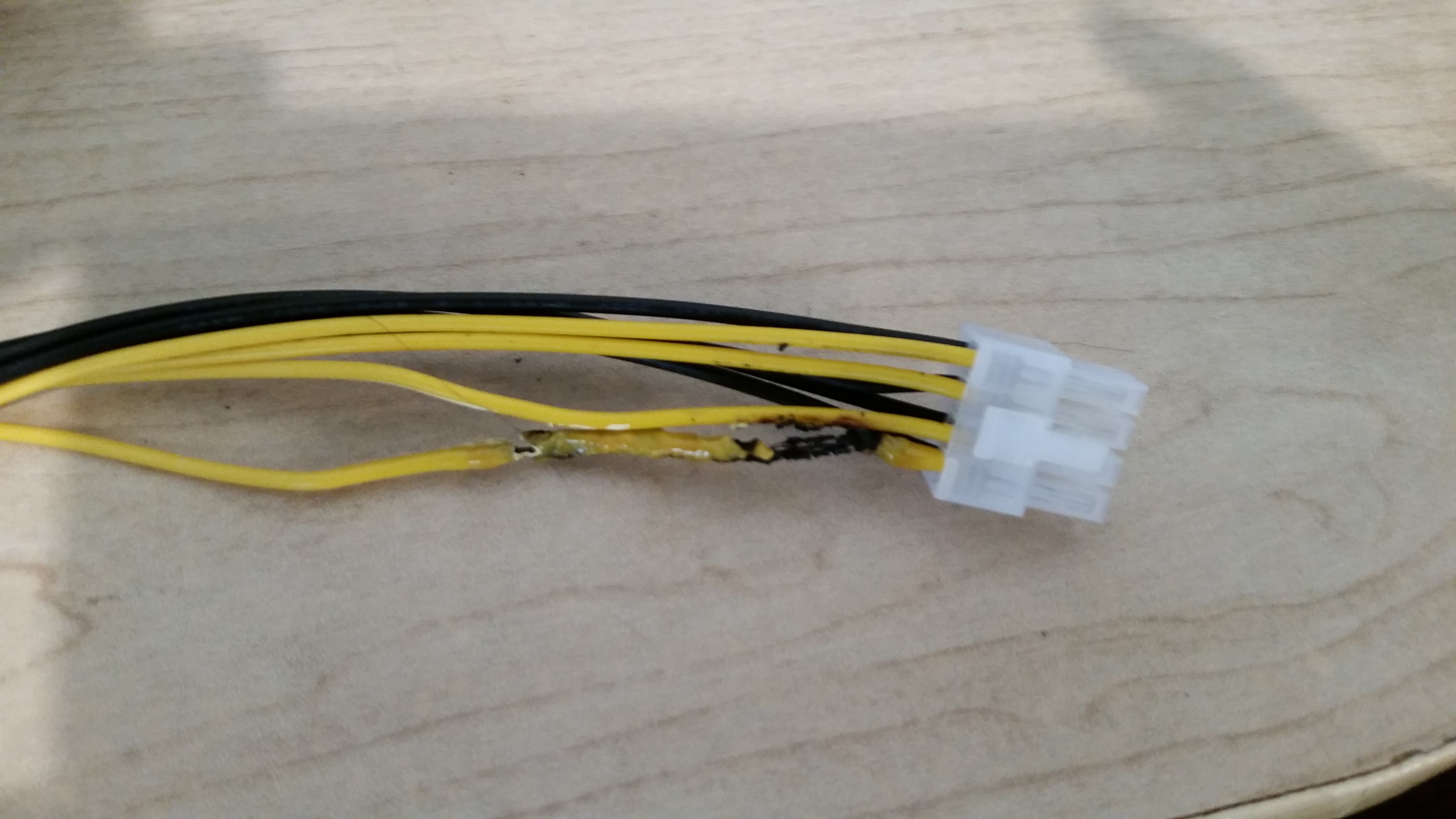

In preparation for this I was playing musical power supplies with my computers and decided to put one in the server for a few days that met the specs but needed an EPS extended cable. Some can guess where this ended up:
Luckily I was home to smell the burning and shut things down BUT before that happened the server had already rebooted itself and looks like it might of hurt the HBA and/or possibly one of the drives.
I ran a memtest and it checked out so thinking the mobo/cpu/ram is ok. Doesn't look like anything shorted, just melted to the point there would of been low voltage / brownout.
So my questions.
1: What happens if it keeps detecting errors on the 2nd array disk? I am not actively using the array.
2: Is it possible to mount the encrypted cache pool outside unraid so I can pull the data, I was going to ditch that pool anyways.
Learn from my mistake, don't trust cheap china power cables, we all know molded sata cables are bad, well even molex style cables can be bad, these wires are way too thin.
