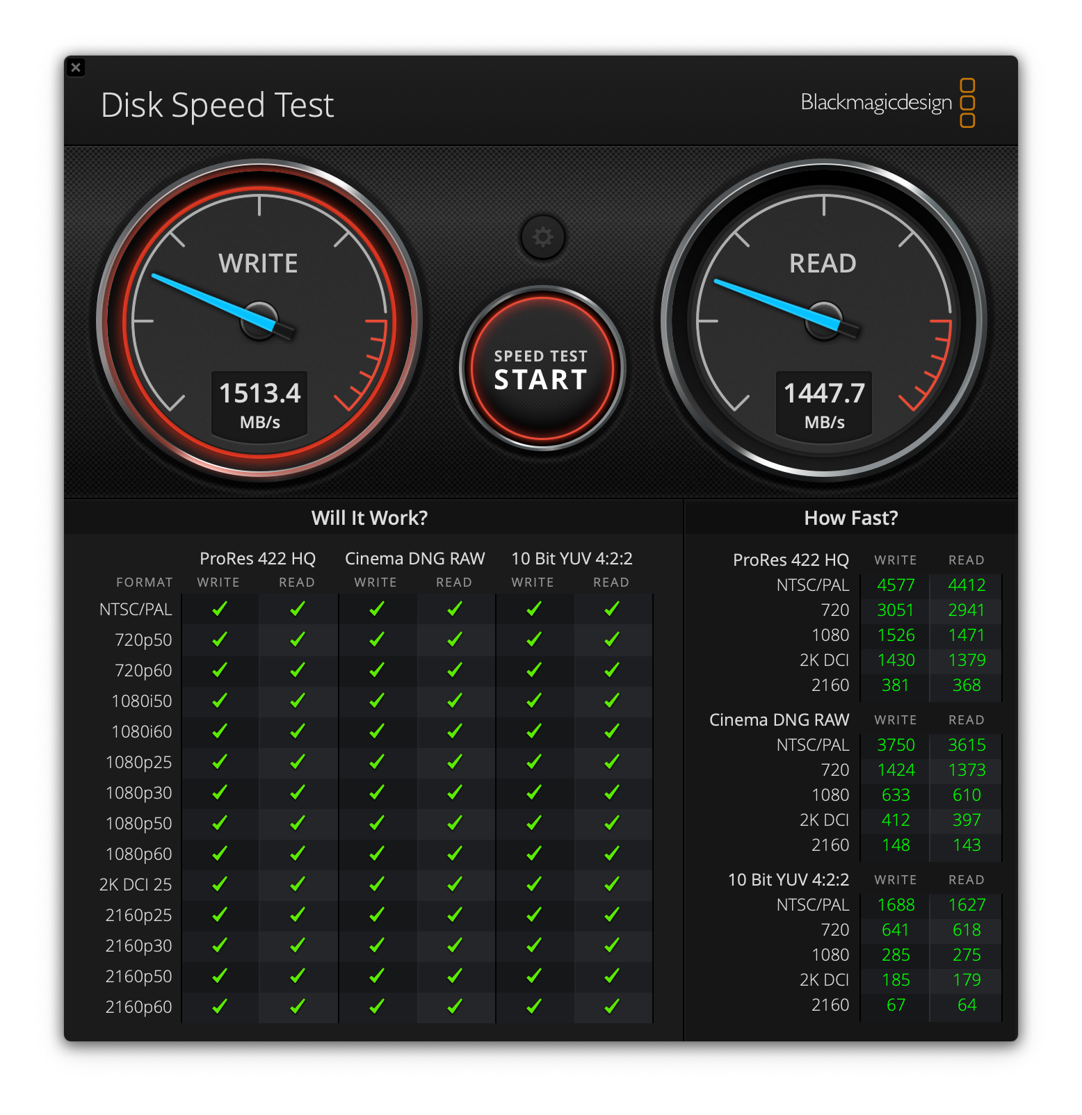

Right now I get write and read speeds round about 1500 MB/s in my VMs (mac OS Catalina tested). On paper PNY XLR8 CS3030 2TB, M.2 should be much faster.
Read: 3500MB/s • Write: 3000MB/

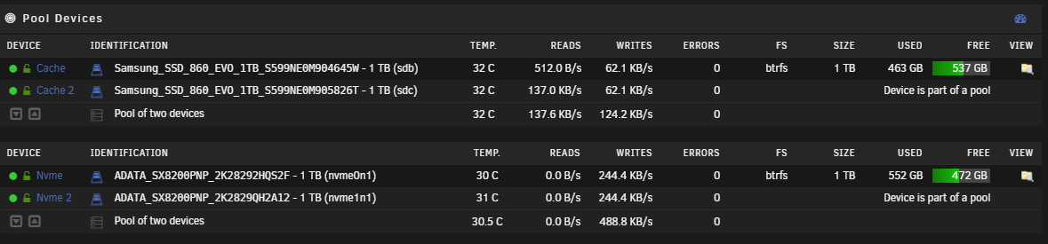

If redundancy is your concern, and you only have one storage device, then you might want to just get a second identical m.2 and set them up as a btrfs raid1 cache pool and forego the array altogether. Probably get better performance than your current setup, and have redundancy.

you can keep your data, unless you are changing the filesystem type, which you may want to do (btrfs raid1 is recommended). If you have another drive to offload the data to temporarily that would work. To switch from array to cache, you would need to create a new config (Tools > New Config) and simply assign the single disk as a cache drive instead of an array drive. Once you have the cache disk assigned, you can easily add the second drive to the cache pool after the fact, and convert it into a raid1 pool without any data loss.
That would offer you the best redundancy. I have two cache pools that are set up in this manner. One with SATA SSDs, the other with NVMe SSDs
