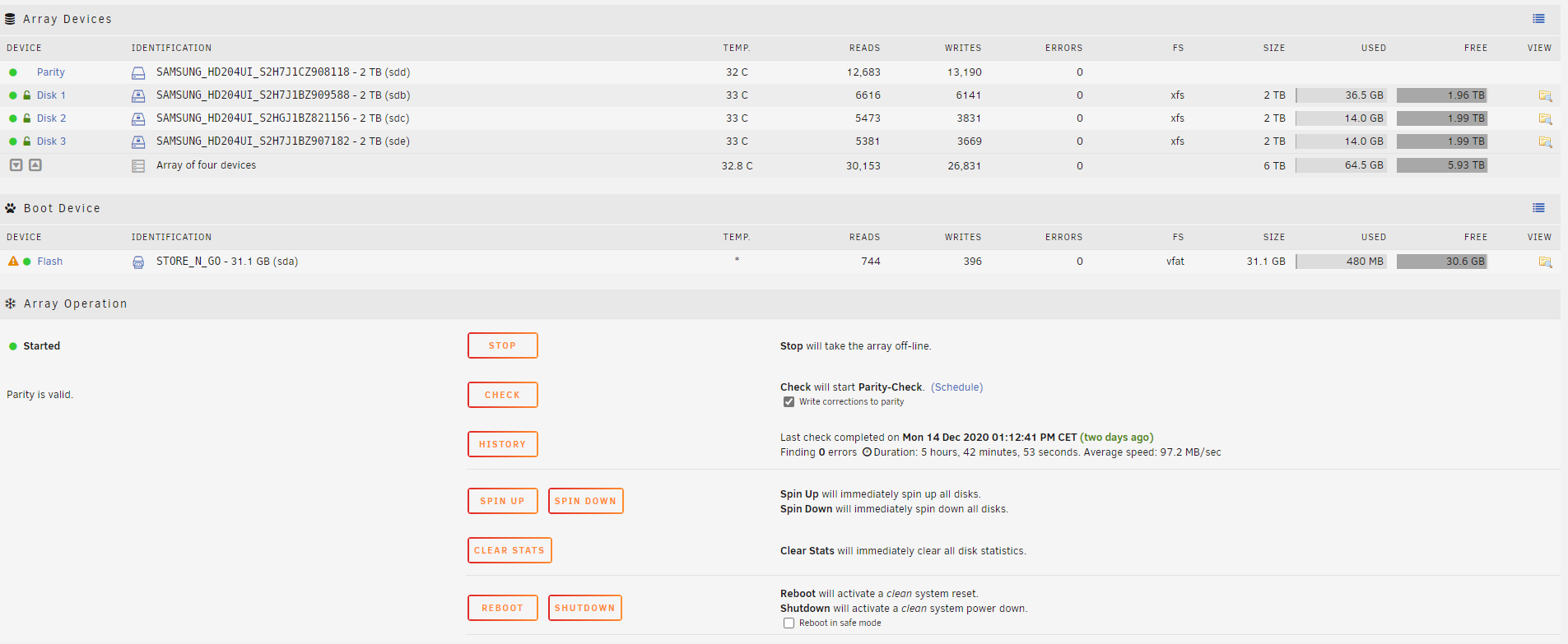

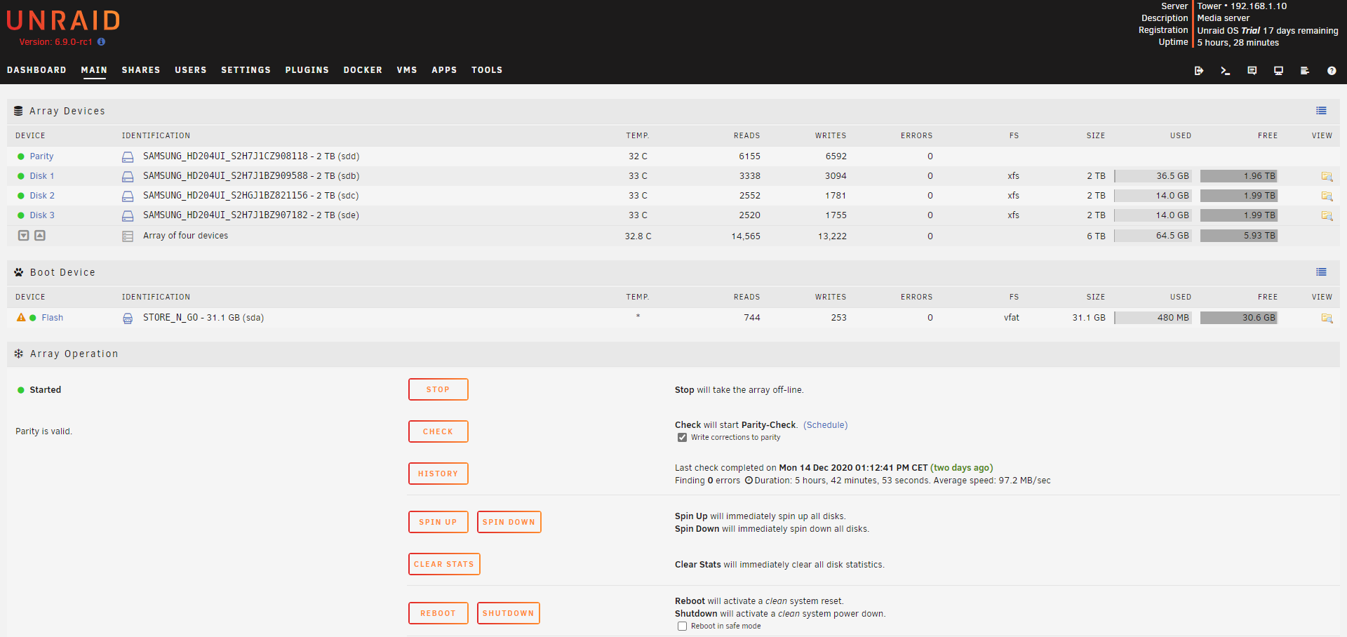

All disks mounted and XFS  formatted:

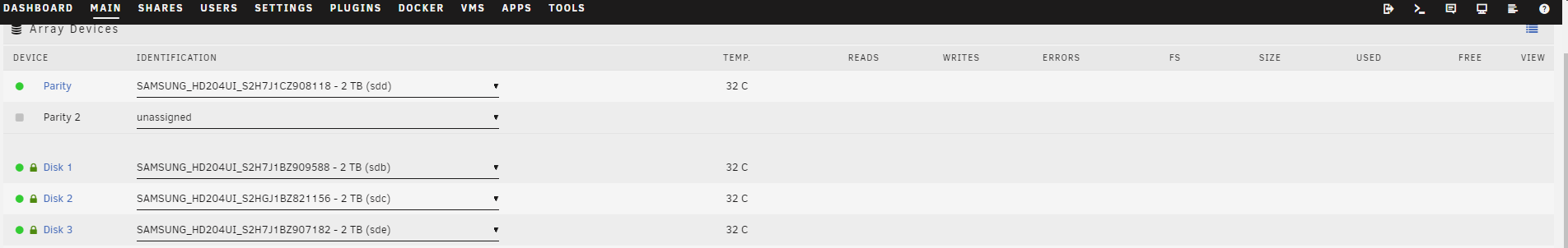

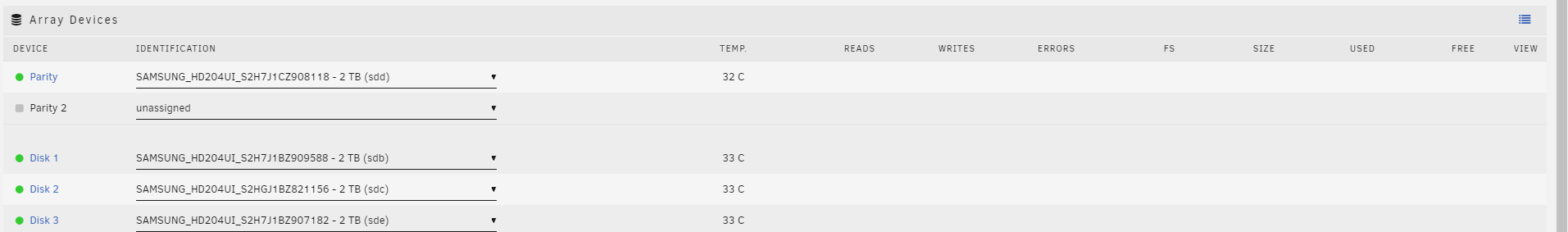

Array stopped:

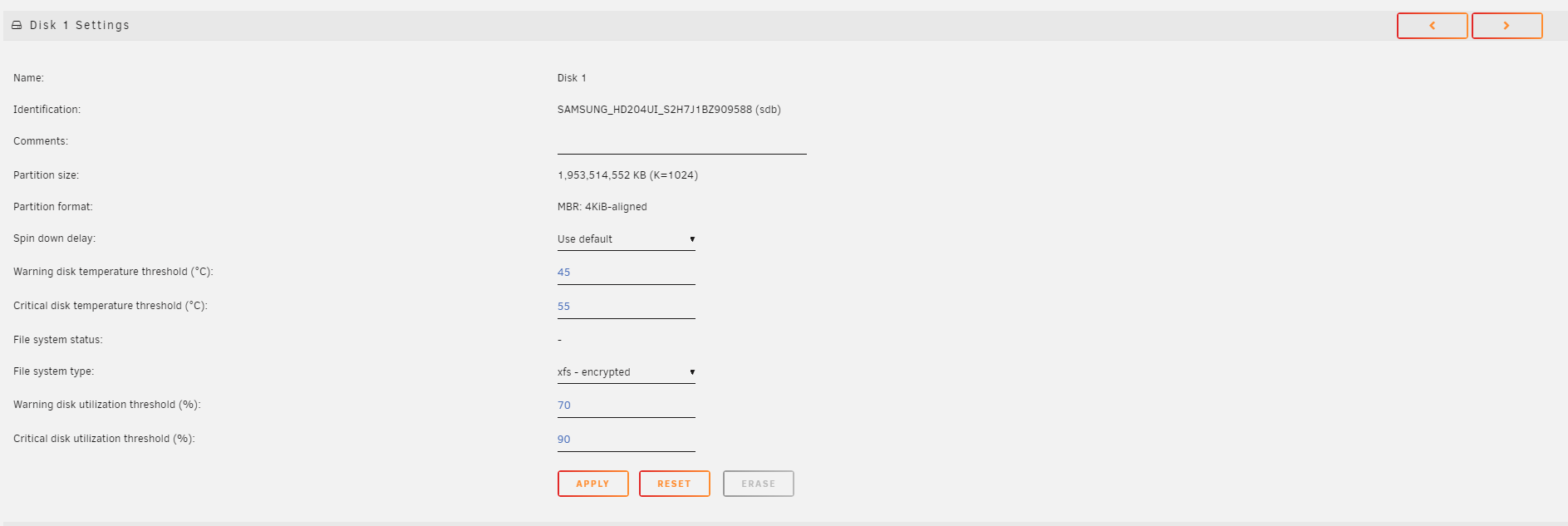

Disk 1 XFS Encrypted

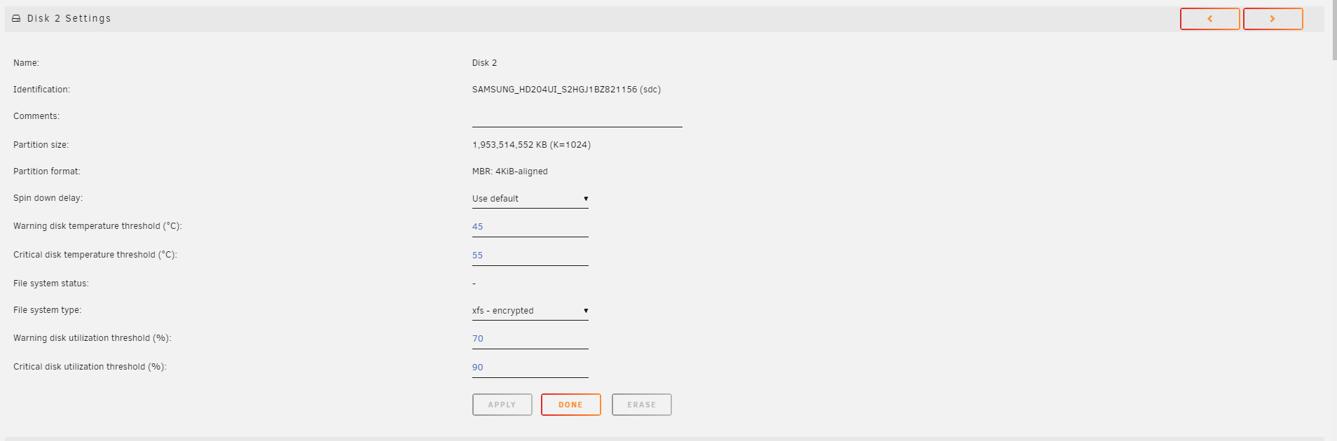

Disk 2 XFS Encrypted
Disk 3 XFS Encrypted

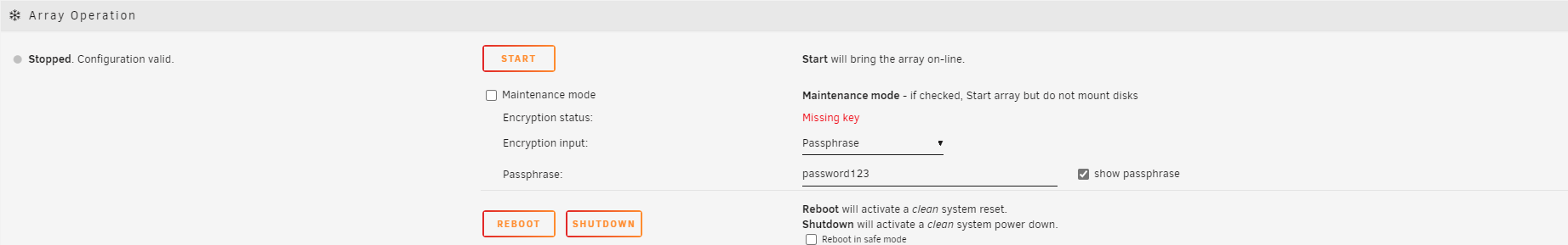

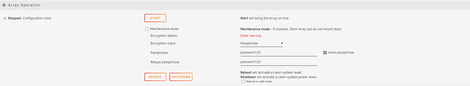

Passphrase set "password123"

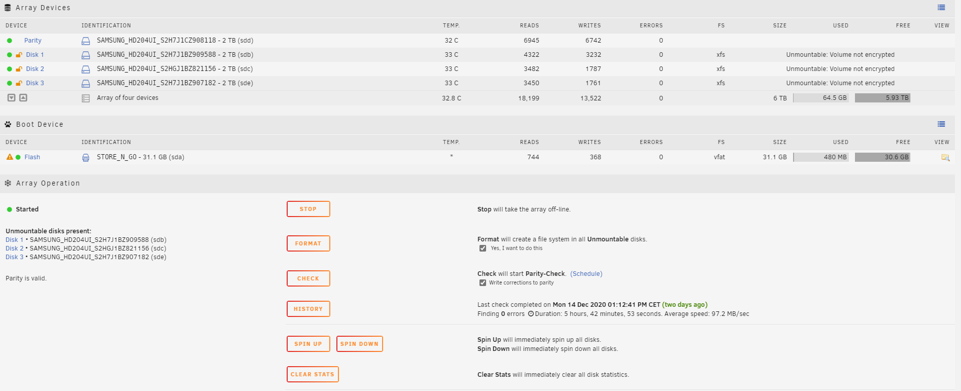

Formatting disks:

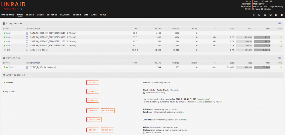

Disks Encrypted & Unlocked

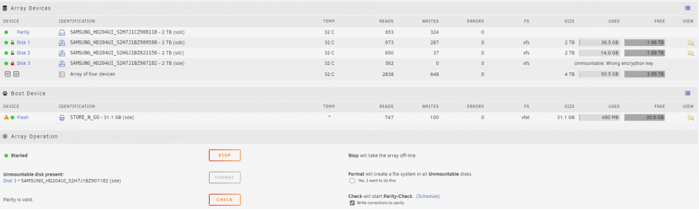

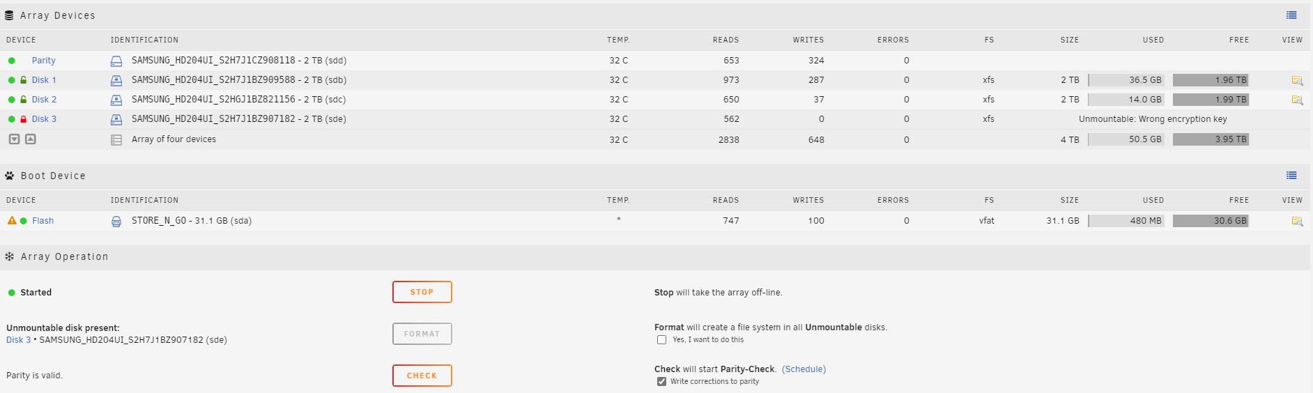

After server reboot disks encrypted & locked

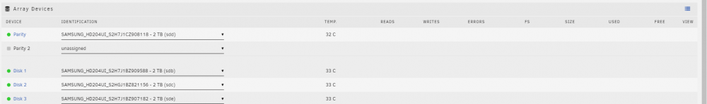

Enter Passphrase and Start...
And two of the three disks get unlocked and the third stays encrypted...
I have also attached two diagnostics..one before reboot and one after..
BEFORE REBOOT_tower-diagnostics-20201216-2144.zip AFTER REBOOT_tower-diagnostics-20201216-2152.zip

Thank you for the detailed info.  If you reboot again is it the same 'disk3' that again reports wrong key?
Yes still the same...
It's not a disk problem because when I only encrypt disk 1 & 2 I have the same issue

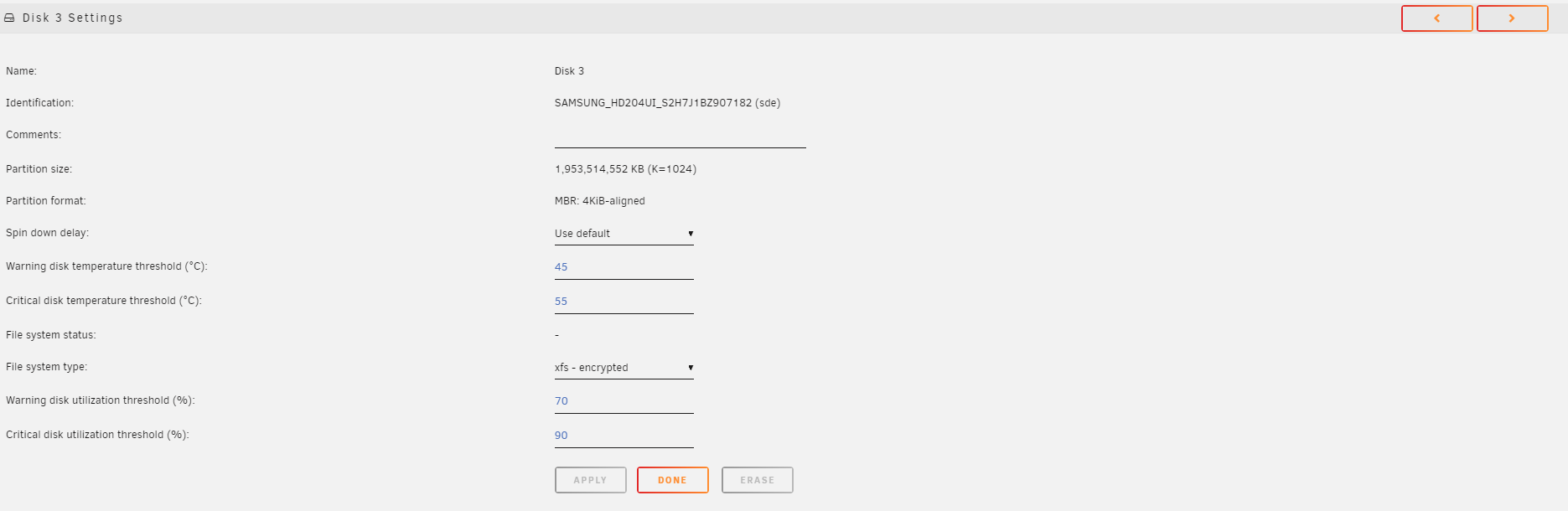

Probably not the problem, but I noticed this screenshot still has the APPLY button enabled as if the change hadn't been applied.
You can see in the screenshots after that the disk is xfs encrypted.

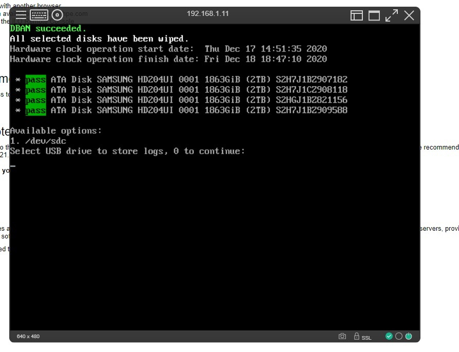

Yes it works now!
Running DBAN solved my problem. Probarly some hidden partition.
Everyone thank you for the patience and efford!

DBAN is a data wiping software so I assume that some hidden files or partition(s) on the disks caused the problem with encryption.

I know what it does, just not how this fixed anything because when Unraid OS formats a device we create an entirely new partition structure - no hidden partitions, no hidden files.  It's a mystery...

I'm 100% sure I followed the right steps with setting up encryption. There is nothing that can go wrong. DBAN takes his time to re-format the disk so maybe the Unraid OS formats the disks there are still some files left...I don't know.
Encryption works now and I can finish up my configuration
Maybe this topic will help someone out in the future.
