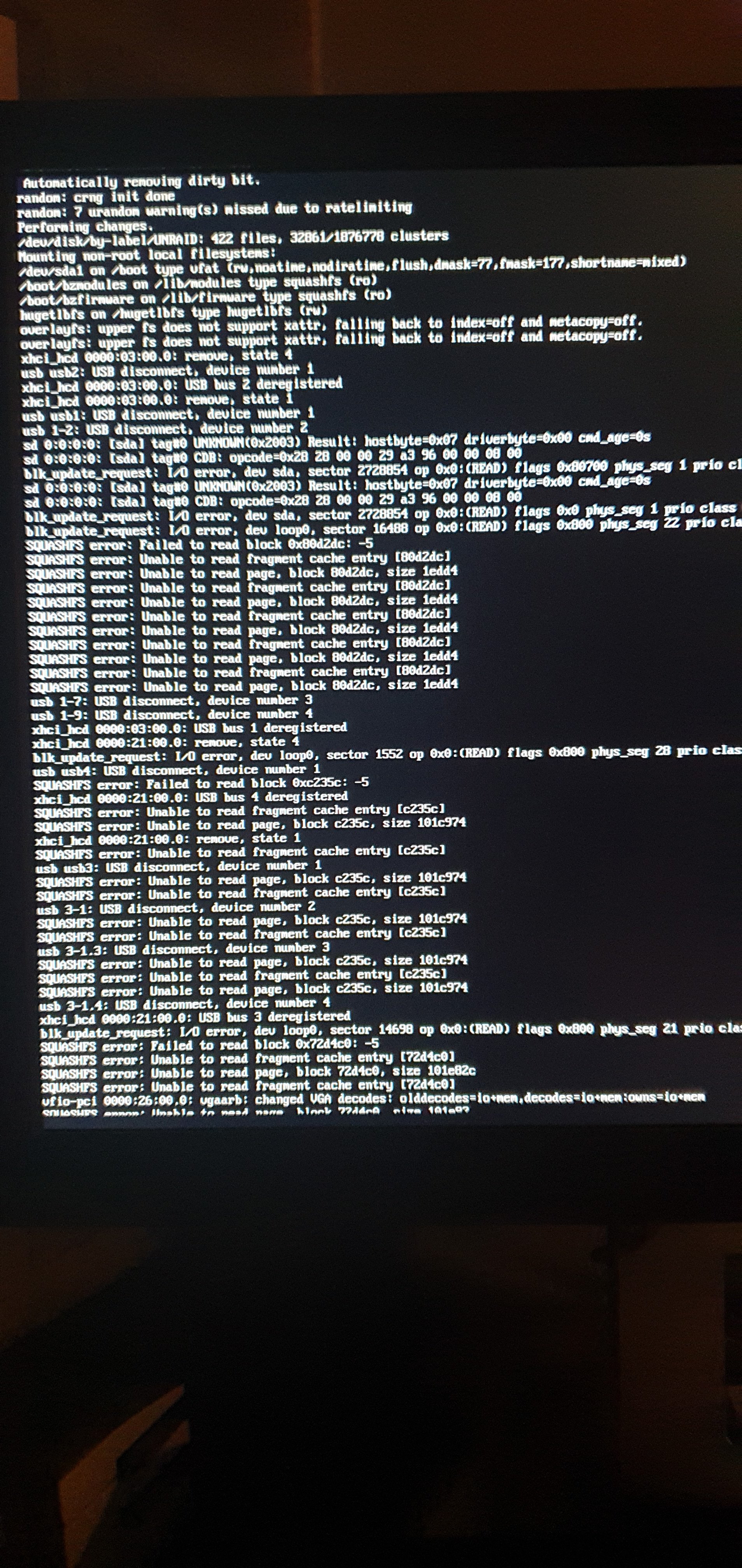

Screenshot shows flash drive problems, backup the config folder, redo-it using the USB tool and restore the config folder, if still issues after that try a different flash drive.

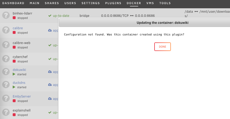

2. Docker containers have no thumbnail images and don't seem to be running:

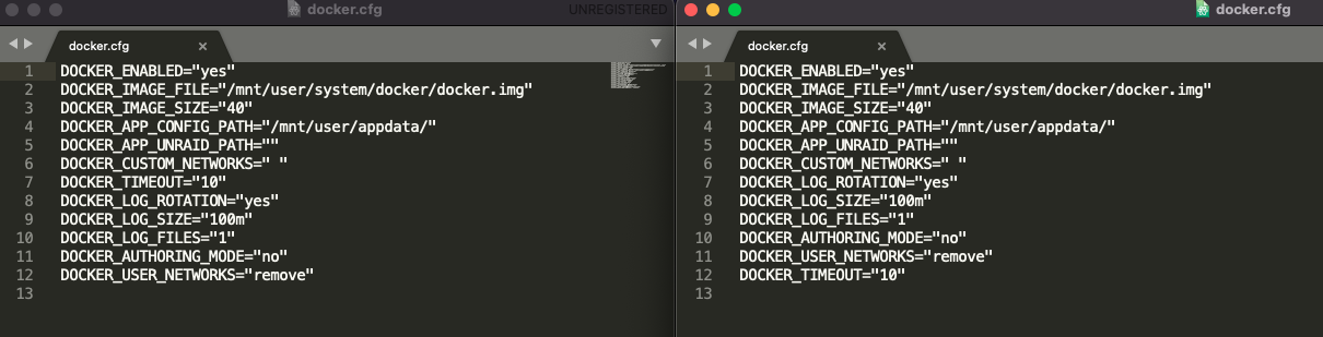

I looked in my docker.cfg and found that a bunch of lines were missing including DOCKER_APP_CONFIG_PATH. I stopped docker, clicked into the selector for config path and pointed to my appdata share again (even though the path looked correct). Saved. Rebooted. Started Docker again. That resulted in the below - new docker.cfg on the left, old/original docker.cfg on the right.
However even with the cfg seemingly correct it isn't finding the docker configuration (see above screenshot).
96161796_Screenshot2020-12-07at16_48_50.thumb.png.4a9a780332e162e80eae4e3b5068a8c9.png
I have checked in the appdata files and they all look intact, the share is located on the cache drive and set to cache:prefer. Am I missing something? Do I need to restore my docker.img file or something else?

Fixed! For reference for anyone else encountering this:
I had to re-install all my plugins - starting with CA and then Fix Common Problems. The latter pointed me to another missing file.
After digging a bit in here: https://wiki.unraid.net/Files_on_v6_boot_drive it turns out the configuration files docker was looking for are stored on the USB boot drive in config/plugins/dockerMan/templates-user as a bunch of .xml files. This folder was empty on my new USB.
I copied the files across, rebooted, and everything works.

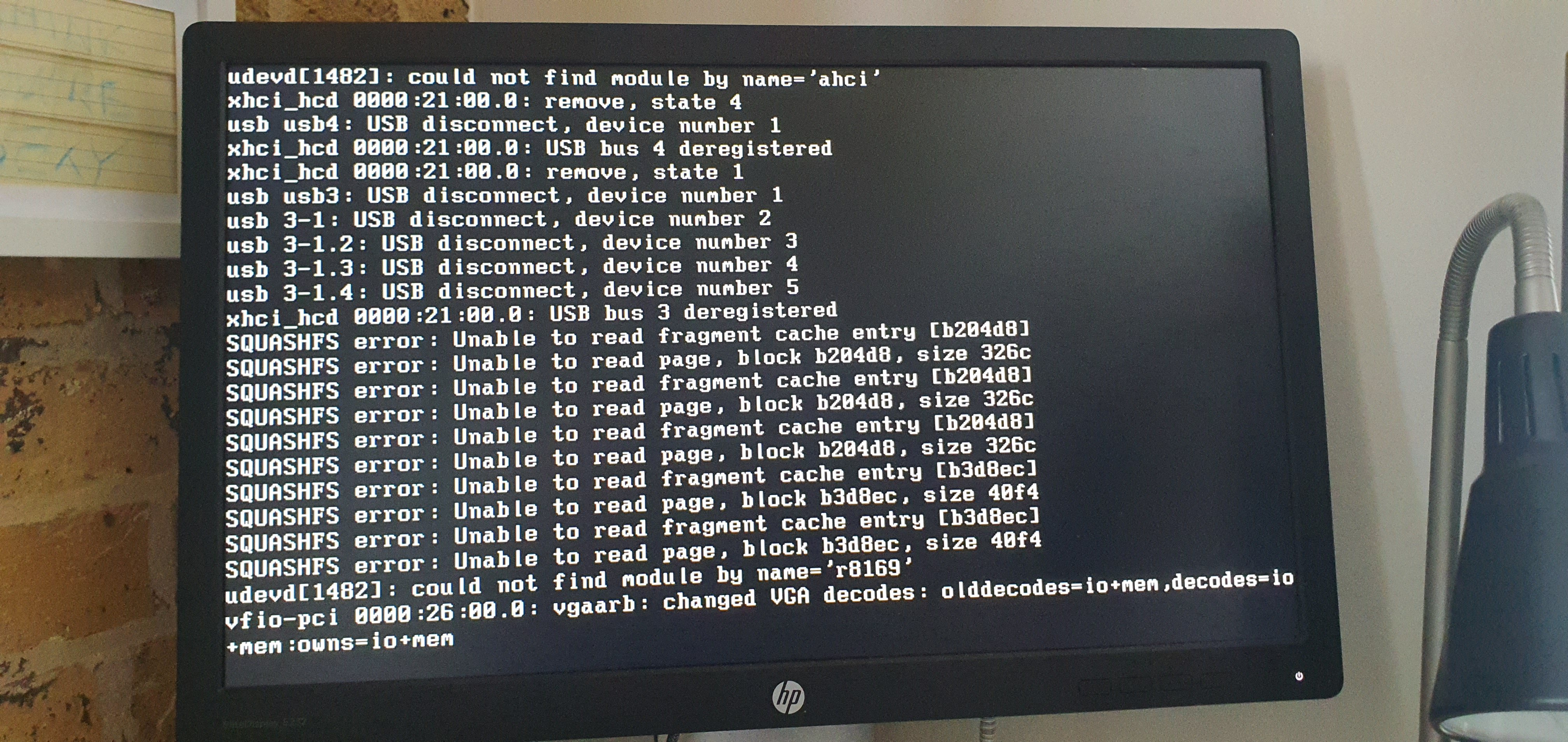

Sure enough, after running in Pop!OS on the passed through NVMe for a while, my POP!Os froze up (same as before). I tried to reboot the VM (running with no vDisk but just the passed through NVMe) - the reboot failed and the VM disappeared. I rebooted the server, and the SQUASHFS problems returned.
I backed up the USB and did a clean install (on the same USB) - restoring only the network.cfg and Basic.key files to the config folder. After re-assigning my drives, the array is back up and running a parity check (17% - no errors so far).
Is this somehow being caused by passing through the NVMe controller? If so, how?
Edited by smkings
Are you using USB 3.0 or 2.0 controller? USB 3.0 is not recommended.
The new USB key is USB 2.0 (old one was USB3.0). The slot it is plugged into is also USB 2.0. I have the non-UEFI boot selected in my BIOS.
Screenshot still looks like a USB/flash drive problem.
