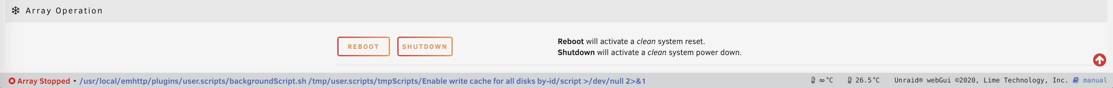

Everything went smooth until this morning I came to step #15. Under Array operation had the "Start" button appeared again after the parity copy was done. I clicked "Start" but it didn't start the array like it says in the manual (and it was no "Yes I want to do this" checkbox either). Everything just stalled.
Current state is this:
1867757344_Skrmavbild2020-12-07kl_12_13_47.thumb.png.bb5b2cb73ac3cab69ee602becd7c1bd6.png
67053365_Skrmavbild2020-12-07kl_12_10_49.thumb.png.b339041f3f75e4d4c47166e55522520a.png
"Array Stopped•/usr/local/emhttp/plugins/user.scripts/backgroundScript.sh /tmp/user.scripts/tmpScripts/Enable write cache for all disks by-id/script >/dev/null 2>&1"

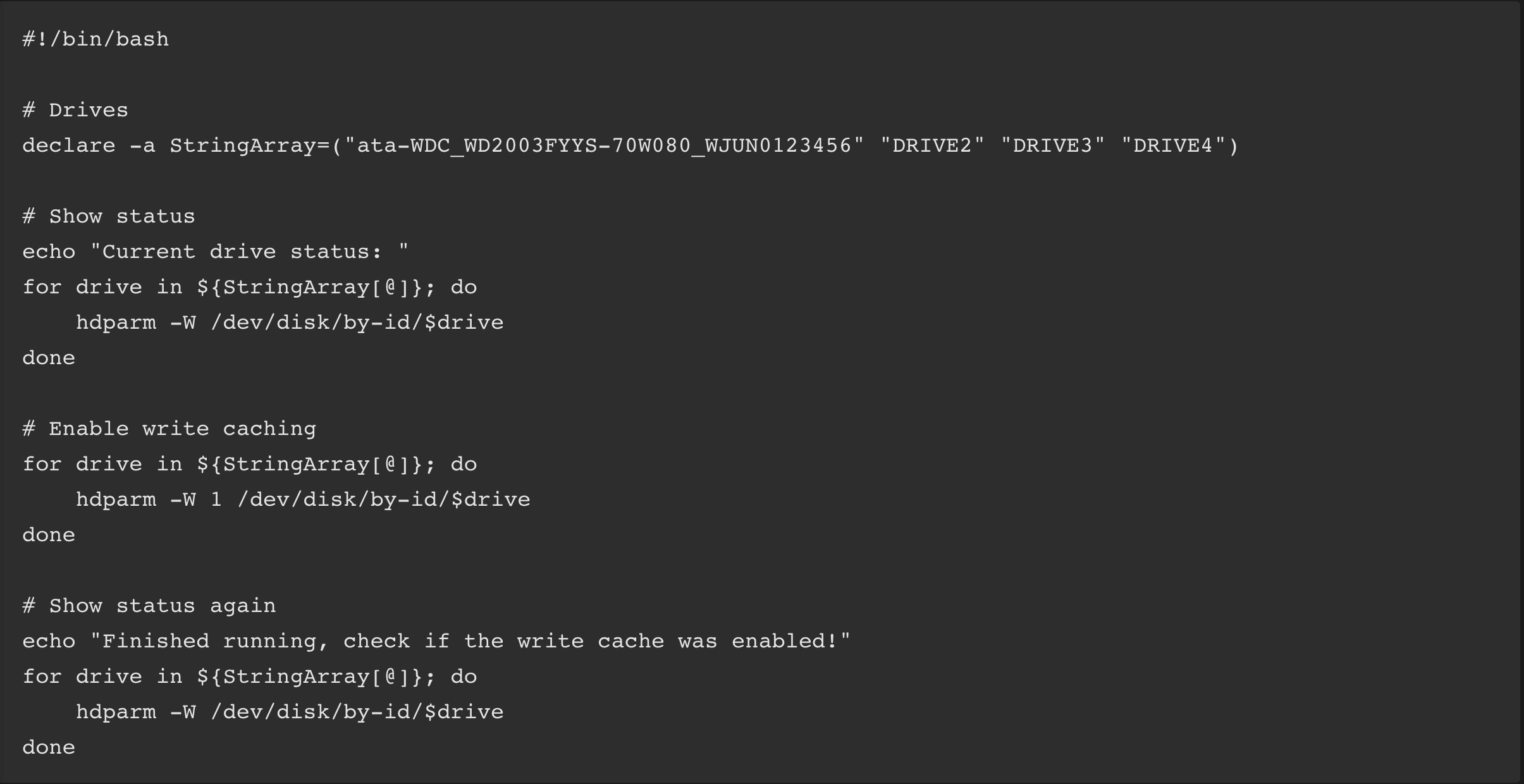

I checked the script for write cache and entered the new 12TB drives serial number (Edit: and removed the 250GB serial number). But I'm not able to run the script?
The script is this from the thread (SOLVED) Set write cache permanently? (with my drives S/N):
917813081_Skrmavbild2020-12-07kl_12_42_13.thumb.png.f56f9ca9ad04954d44381a883d1bc2df.png
I've had the script running perfect for almost a year, because I had some problem that every time I rebooted the server write cache was disabled and I had to run hdparm (if I remember correctly, should really keep personal logg...).

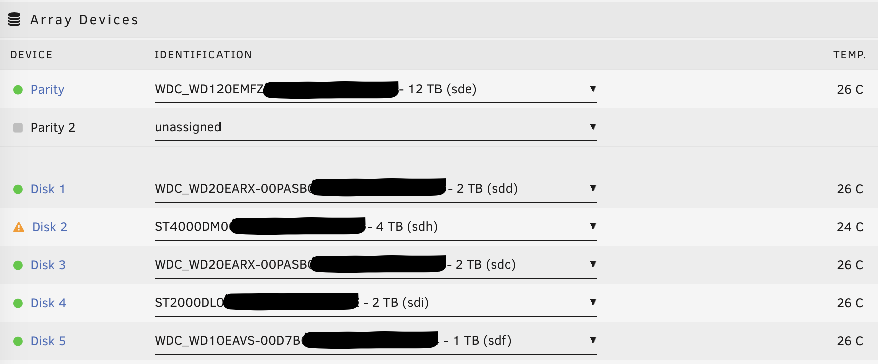

Parity swap copies parity, but it rebuilds the data disk as mentioned in that wiki. Your screenshot suggests the data disk hasn't been rebuilt yet.
That syslog shows parity copy completed and then it seems to show array started and disks mounted but then nothing in syslog after that. Is there anything new in syslog after the syslog you attached?

First I couldn't even connect or ssh to it, but then I remembered I have an unassigned drive connected and maybe it tried booting of that. Removed the external USB-drive and then it booted normal. Since the write-cache script runs on startup and I now had changed it I guess everything was ok so unraid started the Data-Rebuild automatically. Will run a parity check after to check if everything still is ok.

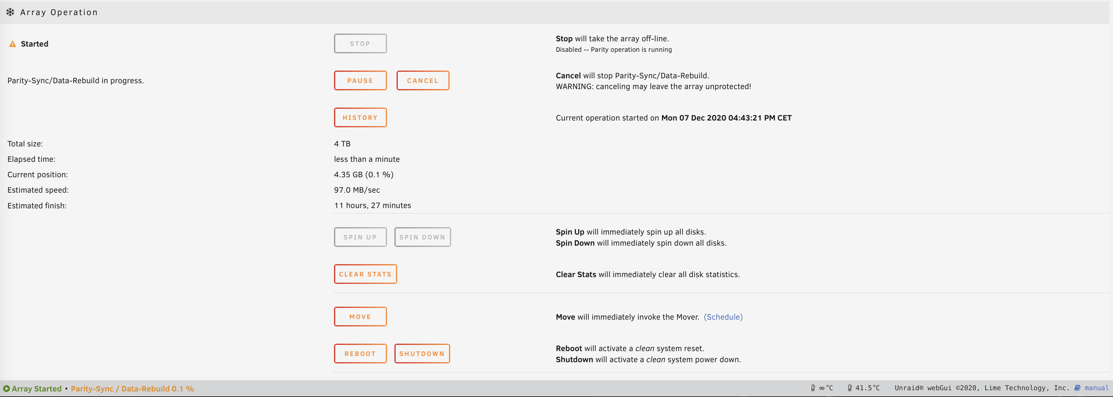

1250610259_Skrmavbild2020-12-07kl_16_44_09.thumb.png.9f92be33fb11a3bae21b8aefd0b7ca90.png
OK, the data rebuild went without a glitch. It wasn't a problem to restart before the data rebuild, at least not this time. I also ran an extra parity check to be sure. So now everything is working. I guess it was the script that messed it up and I'll have to look into that more.
