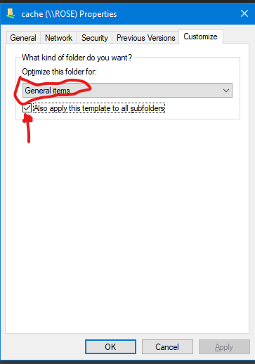

One thing that can help speed up Windows Explorer is to right click on the Share Name in Widows Explorer window.   Then go to the 'Customize' tab.  setup as shown below:
Thanks, I'll try that out today. Do you know why this would work?
Because you are not trying to retrieve information for things like thumbnails.
