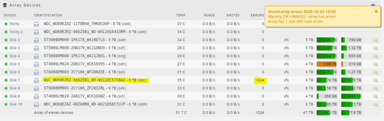

One of my data drives started showing read errors in the dashboard/log, although SMART doesn't look too problematic to me.  The drive was one that previously seemed questionable, so I'm going to go ahead and replace it to be safe.
I have dual parity, and the replacement drives I have available are bigger than my 2nd parity drive.  I'm trying to decide what steps to take to upgrade the parity drive and replace the data drive.
Which disk specifically?
Nevermind, I see it is disk7.
Yep.  Here's the devices list if it helps:
