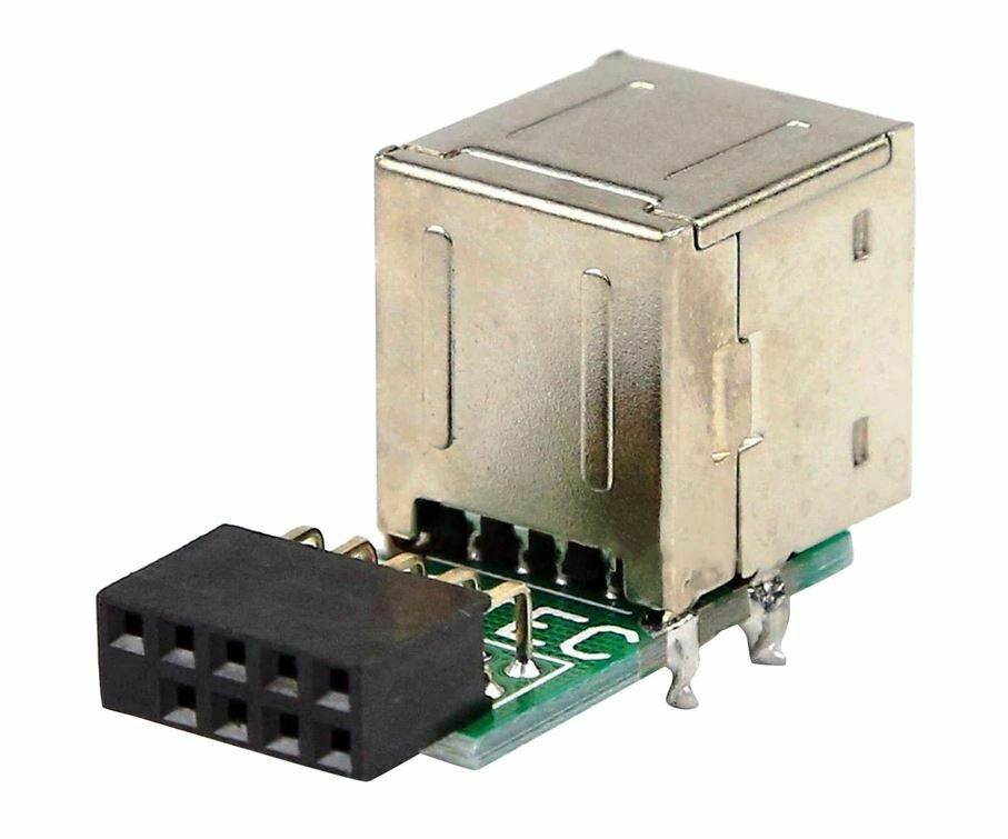

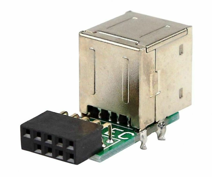

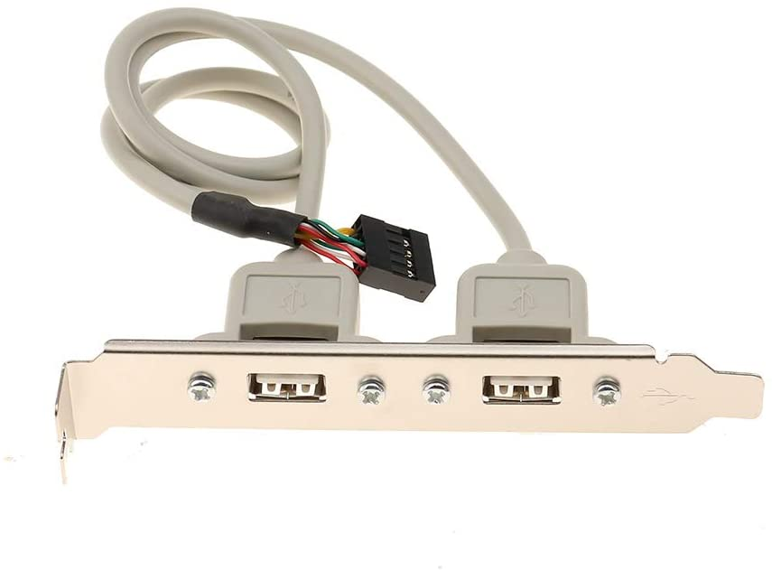

However... I highly recommend NOT moving to a mini drive, they don't have very good lifespans compared to full size drives, the concentrated heat seems to kill them. You would be much better off getting an adapter to move the stick inside the case. Something like this, I typically bend the L shaped bit back straight and stack it to an unused slot.
Thanks, I'll give that a try.
