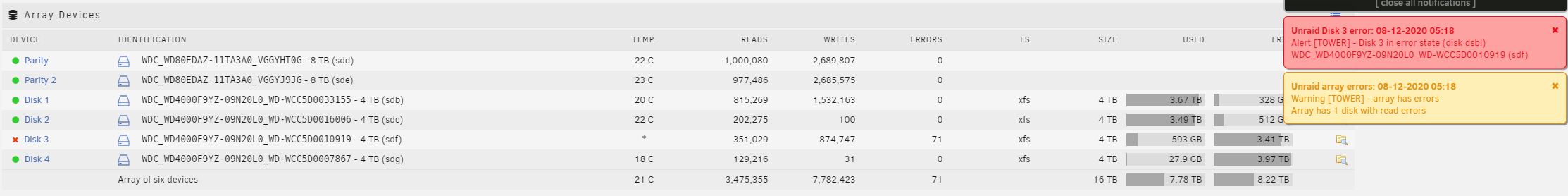

Yesterday morning I had one of my drives get disabled due to errors. How can I determine the cause of the errors, and if this means there's an issue with the drive, or an issue elsewhere?
The disabled drive is fairly old, so I wouldn't be surprised if it's on it's way out, but I want to be sure before doing something about it.
I've attached my diagnostics zip, but it's missing the SMART data for the disabled drive (due to it being disabled). I've now uploaded the SMART result from the failed drive after a restart. The SMART test has passed.

So a follow up on this. I've tried swapping SATA cables & changing the SATA port the drive is connected to, but I've had errors a couple of times since trying these.
Only thing I haven't done yet is trying a different PWR cable, but there are other drives on the same chain, so thinking it's unlikely to be that, but going to try and determine for sure.
I've attached the diagnostics for the last couple of times it's had the problem. Do these give any further idea on what might be the issue?
tower-diagnostics-20201231-2033.zip tower-diagnostics-20201227-1150.zip
