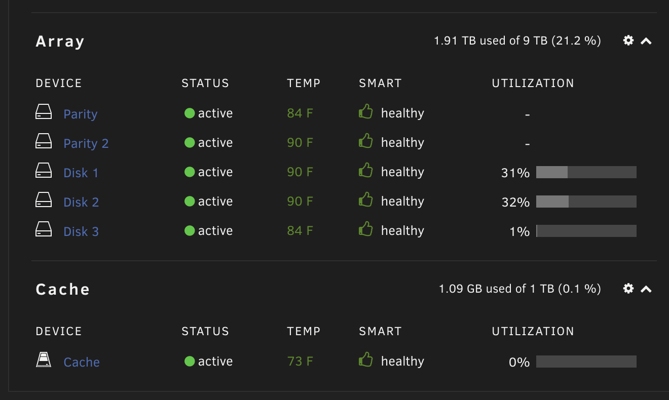

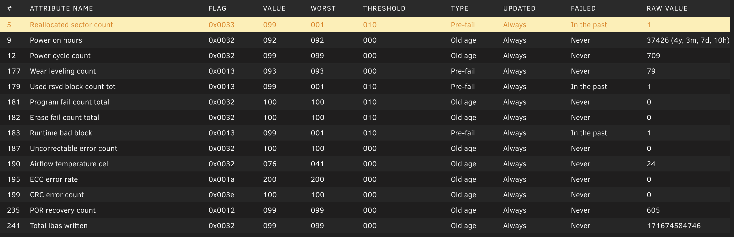

Sorry for the convoluted subject line.  I'll explain.  I have a 1TB SSD with a single reallocated sector.  I've set that up as my cache drive, but the Dashboard tab on Unraid was showing a thumbs-down 👎 next to "healthy" for that drive.  So I clicked on it to override it to healthy, thinking that the status going to unhealthy again will alert me to new sector reallocations.
But I had second thoughts and wondered how I could reset it so that it would go back to the default behavior of a thumbs-down for that SSD.  At first, I hoped it was a browser cookie, but I proved that wrong.
Does anyone know how to return that indicator to its normal function (thumbs down on that drive because it has a reallocated sector)?
If you hit "Clear Stats" button on the main page of the GUI it should switch to the thumbs up.  If you get any more reallocated sectors it will switch back to thumbs down.
Thanks, but that didn't affect the thumbs-up I am seeing on the Dashboard.  It started at a thumbs up "healthy" on the cache drive and it stayed at a thumbs up "healthy" even though there is one reallocated sector.
I want it to go back to showing thumbs down for any drive with more than 0 reallocated sectors -- like it did before I acknowledged the thumbs down on that cache drive.

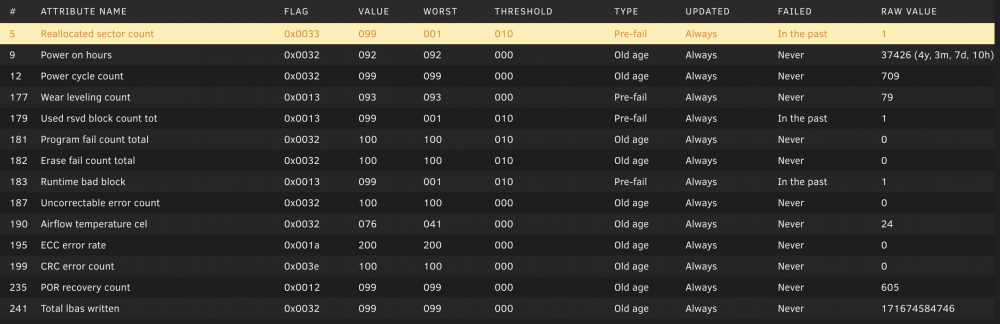

Most SMART attribute are never reset.
Once the drive has a realocated sector, I don't think the value will go back to 0.

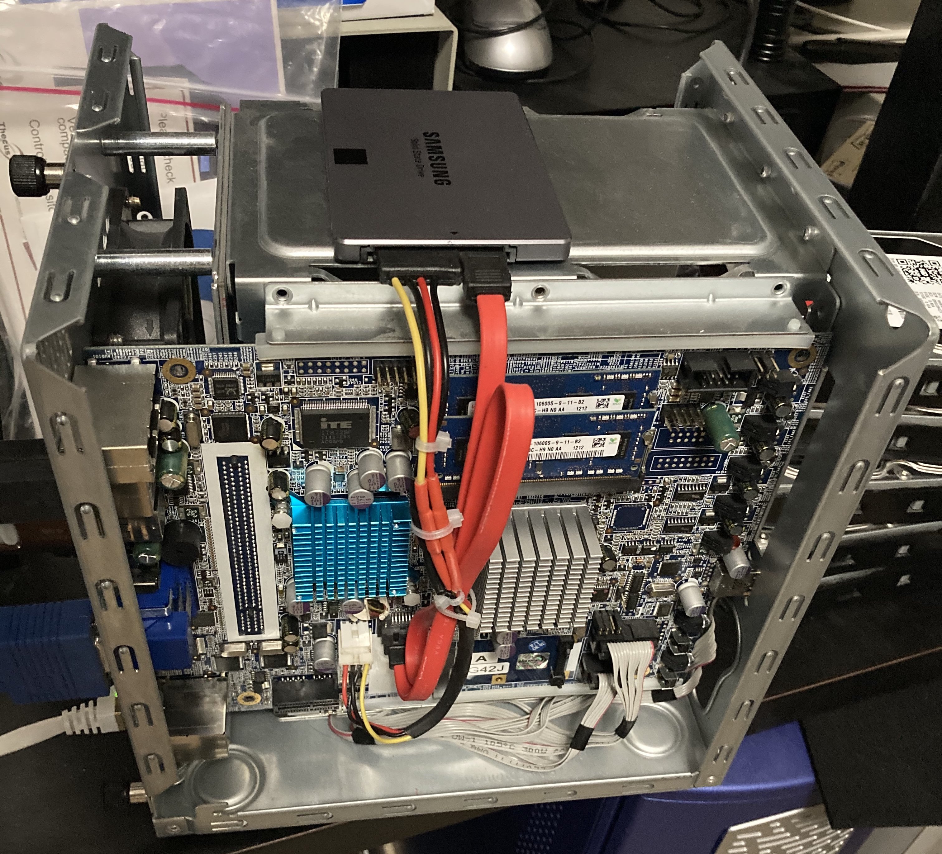

22 hours ago, Sissy said:
1TB Samsung 840 EVO in its place
So good that Thecus have extra SATA port for this, my QNAP have too but no SATA socket solder on PCB.

I did as you directed and it worked perfectly!
Unraid rebooted and immediately flagged the drive's health after providing a notification of the reallocated sector.
