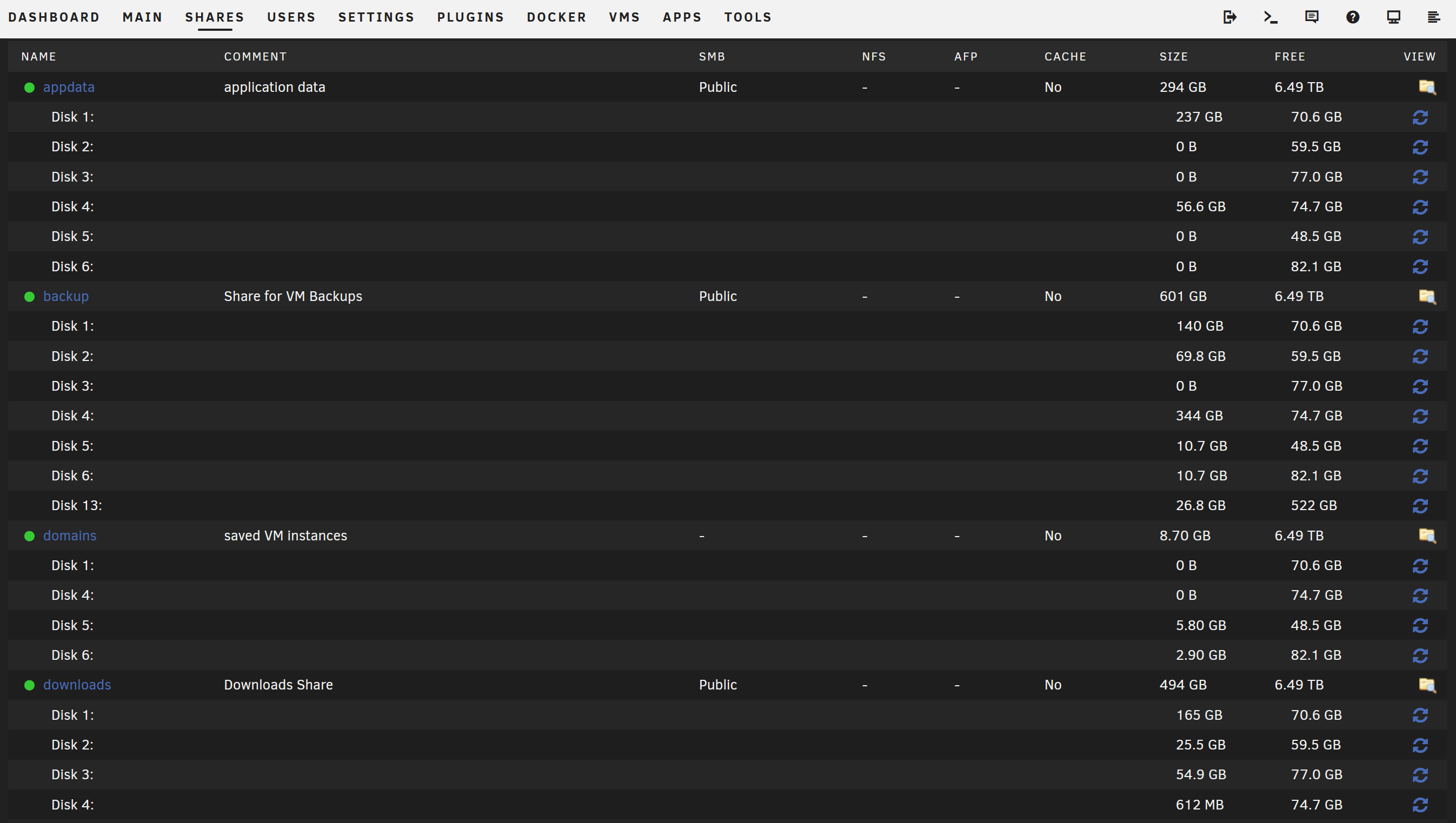

Go to Shares - User Shares and click Compute All button at bottom of page. That will show you how much of each disk each User Share is using, and also the total usage for each User Share. It will probably take several minutes to produce all the results. You may have to refresh the page.
Post a screenshot of the results.

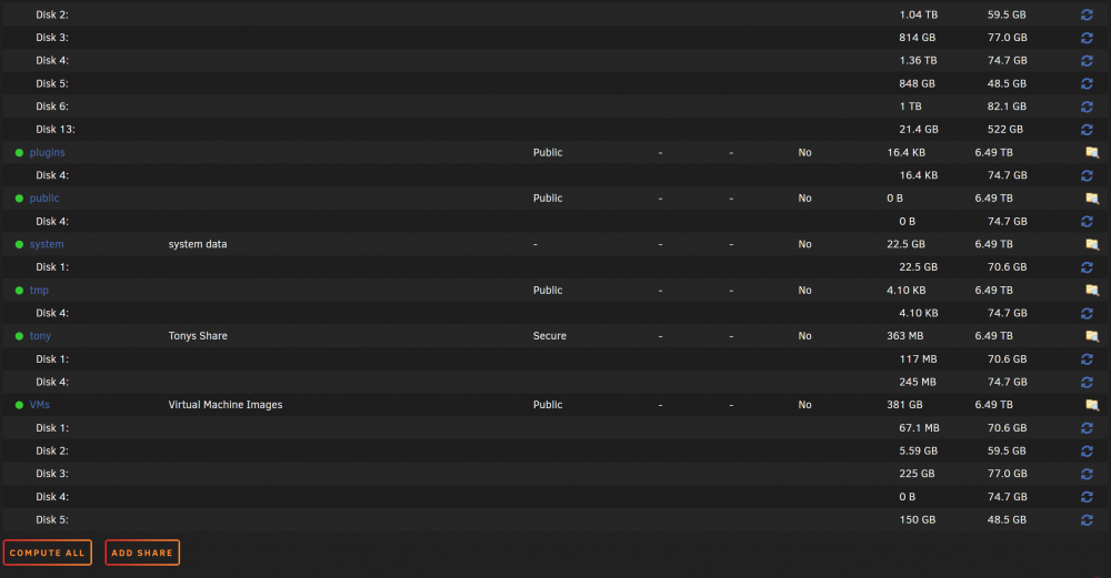

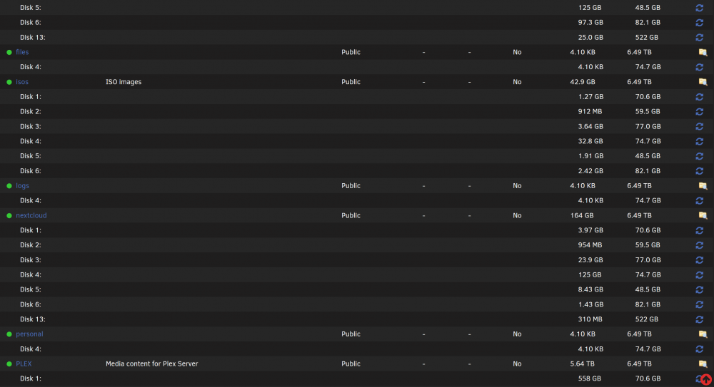

@trurl here is the shots;
Looks like 1TB might be needed after all.
