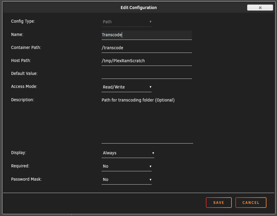

I have 64GB RAM in my server and  I limit the transcode location in RAM to 16GB max and it probably does not even need that much.  I only have it that high because I also have HDHomeRun tuners which I have set to record and transcode on the fly via Plex and that can use quite a bit of RAM if multiple simultaneous records are happening.
EDIT:  Here are my go file entries for setting up a 16GB max. transcoding scratch area:
mkdir /tmp/PlexRamScratch
chmod -R 777 /tmp/PlexRamScratch
mount -t tmpfs -o size=16g tmpfs /tmp/PlexRamScratch
And, of course, /transcode in the Plex docker container points to PlexRamScratch and in Plex to /transcode.

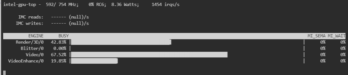

Hi there, i'm using ASRock J3455-ITX, 16GB RAM.
weird, my system is solid rock stable with 6.8.3, Jellyfin-AMD-Intel-Nvidia docker + Intel GPU Top. Capable to transcode HEVC to H.264 no less than 100fps (mostly around 120fps).
Edited by Lee Kim Tatt
