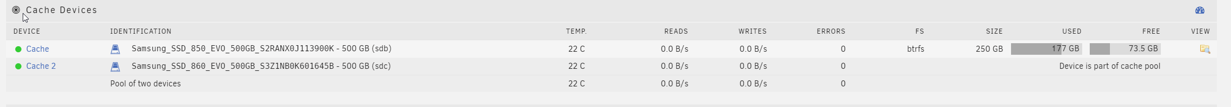

I am trying to remove 1 cache drive from a 2 drive cache pool. when i stop the array, remove the drive, it wont let me start it back up with 1 drive.
Somehow its now a raid 0, i guess i just need to clear all cache drives and re-add a single one.
Whats the best process for this? I already have appdata backed up, but whats the best practice for the system folder? change cache form prefer to no?

My system is doing some strange stuff. my cache array is now showing 250gb instead of 500gb. I tried to convert to raid 1, but its doing nothing. I trying a full balance now, then will try to convert to raid 1.
I tried following the guide before and when I removed the cache drive, it would not let me start the array since there was not a 2nd cache disk assigned.

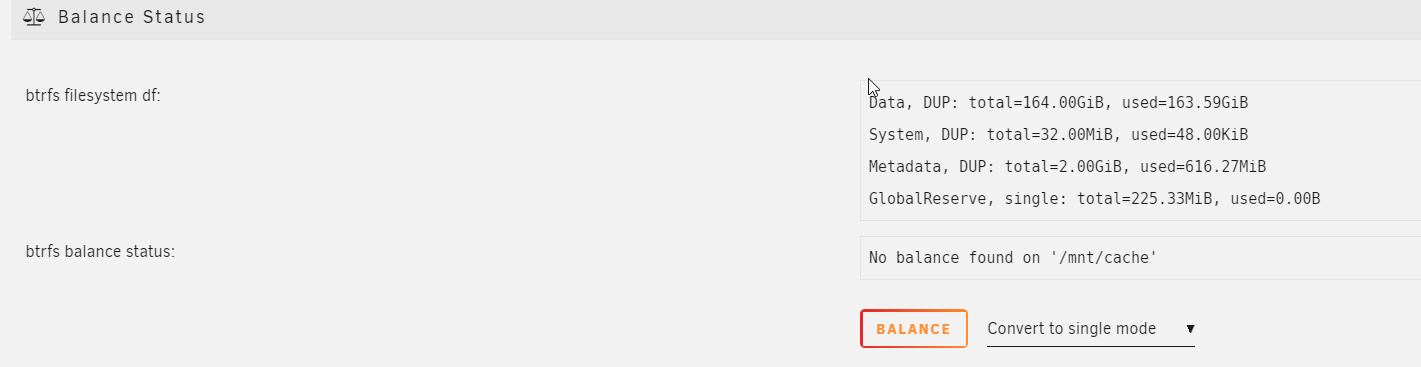

Looks like i'm getting a error trying to convertbalance: invalid convert data profile raid1

Cache is currently a single device, so it can't be converted to raid1:
             Data      Metadata  System
Id Path      DUP       DUP       DUP      Unallocated
 1 /dev/sdb1 328.00GiB   2.00GiB 64.00MiB   135.70GiB
   Total     164.00GiB   1.00GiB 32.00MiB   135.70GiB
   Used      163.59GiB 616.27MiB 48.00KiB
For some reason you are using the DUP profile for data, convert to single.
When I try to convert to single mode, I get this error in console:
Dec 12 07:26:14 Tower ool www[23487]: /usr/local/emhttp/plugins/dynamix/scripts/btrfs_balance 'start' '/mnt/cache' '-dconvert=single -mconvert=raid1'
Dec 12 07:26:14 Tower kernel: BTRFS error (device sdb1): balance: invalid convert metadata profile raid1
Edited by Spikerman
You cannot have the -—mconvert=raid1 option with only a single device in the pool
@itimpiit shows two devices in pool
and when I go to convert here, it pipes out that error when trying to setup a single
bump
But that's not correct, like I mentioned above
You can balance to single and remove the other device.
@JorgeB how do I balance it to single then? Is there a command I need to use directly in terminal?
bump
btrfs balance start -dconvert=single /mnt/cache
ran the command and now cache is showing as
Data, single: total=164.00GiB, used=163.59GiB
System, DUP: total=32.00MiB, used=48.00KiB
Metadata, DUP: total=2.00GiB, used=617.25MiB
GlobalReserve, single: total=226.34MiB, used=0.00B
I am following your faq post @JorgeB on the process.
