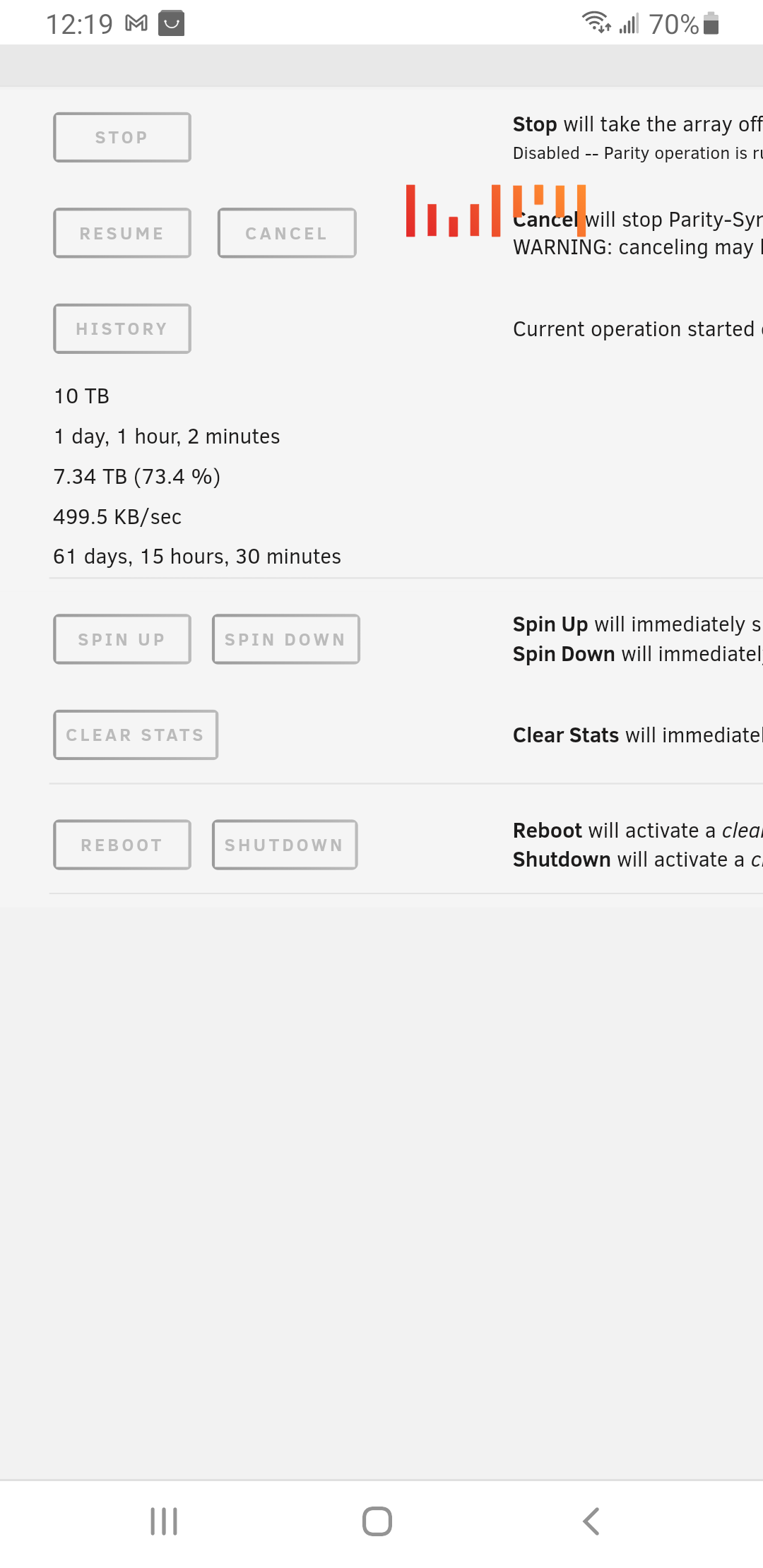

4. started data rebuild (1st time) and it was hitting 80MB/sec until 40% and drop to 500KB/sec
5. rebooted the server, started data rebuild again (2nd time) and it was hitting 80MB/sec until 50% and drop to 500KB/sec
Currently still running the data rebuild as I'm posting this, please provide help!
UPDATE:
Currently its on 50.3% and rebuilding at 100KB/sec, still hoping it will speed up or I'm force to copy off the data from the emulated drive and start new configuration

Hi @JorgeB, bad news... so it ran in safe mode data rebuild for a day and was going at 80-100MB/s, and all of sudden it dropped to 750KB/s... attached is the diagnostic logs if you can help, thanks!

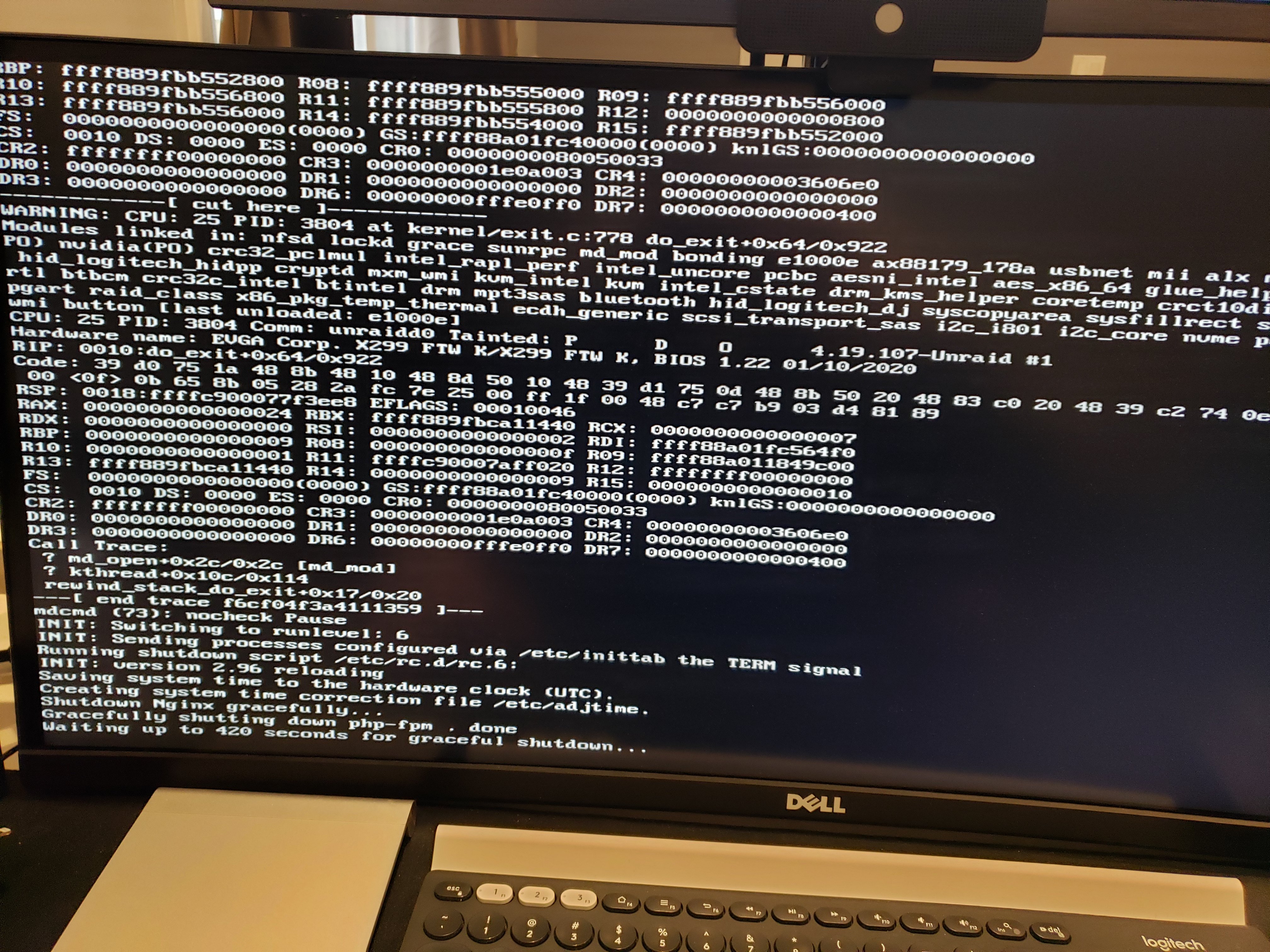

This is the kernel logs when I clicked pause and trying to reboot the server.
Edited by jamesy829
Call trace always indicate something wrong, you need dig out the cause.
Yea, I tried to access the logs but no dice as the WebGUI just keep loading so I decided to reboot. It did generate a diagnostic report thou which I'll try to pull out (not sure where it saved at)

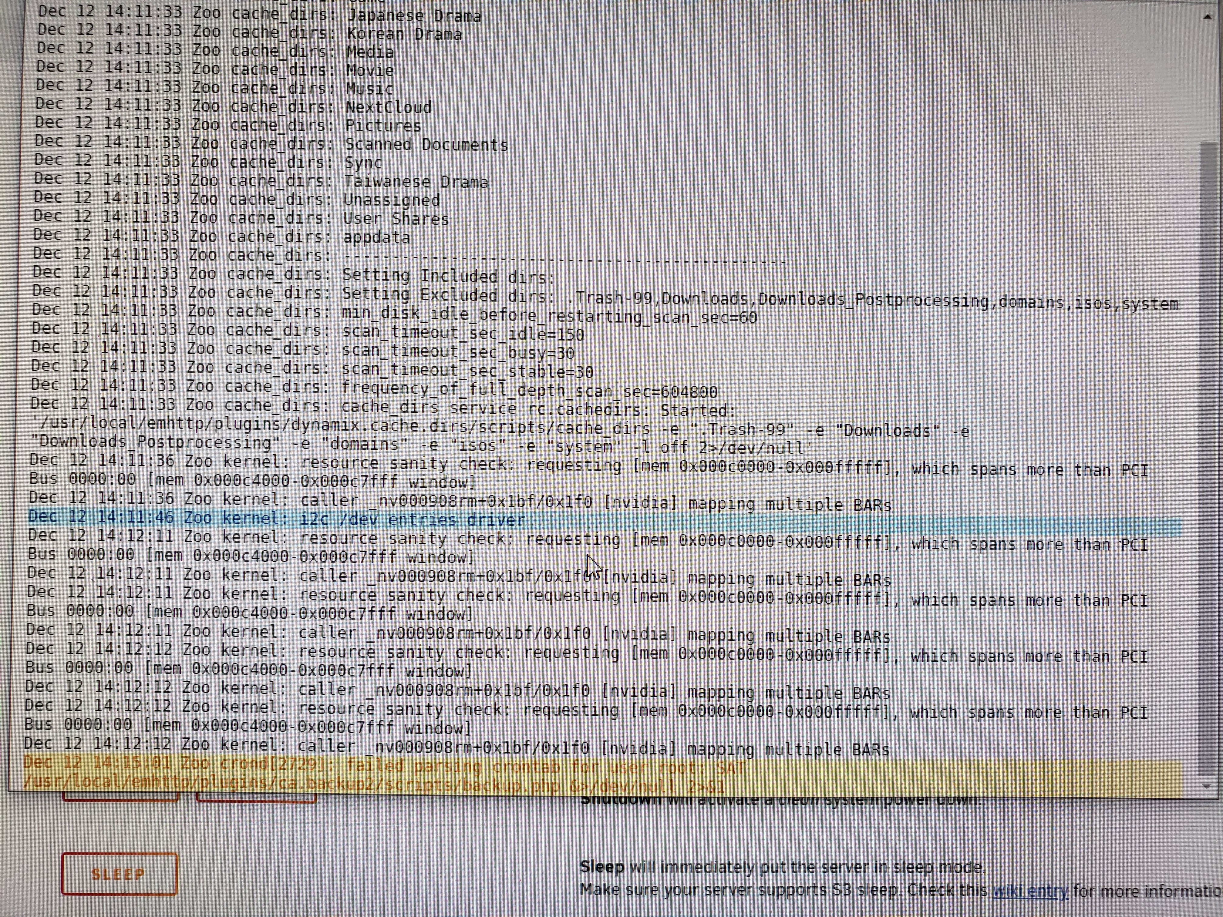

Oh didn't notice you modified the msg, yea, the board is sick and I'm running the 10980xe, but maybe I should update the BIOS (which I need to figure out how). I just did a new config with no parity and it start up fine. But I'm seeing weird kernel errors (could be I am using old unraid nvidia kernel that caused system to errror?) And 1 or the error i saw was the backup plug-in thats in the screenshot.
Edited by jamesy829
Those error seems not critical.
