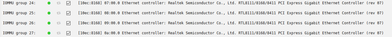

i installed pfSense on a VM (following spacveinvader one video) and i was trying to pass through 3 eth nics but on VM i see just the first nic and not all 3.
I m running unRaid Version: 6.9.0-rc1, i set PCIe ACS override on Both, i bounded Nics to vfio (through System Device), on VM option i selected the 3 nics.

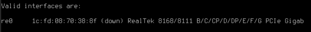

This is what i see from pfsense (interface is down cause i still have to connect cable):
Do you have any suggest ?
