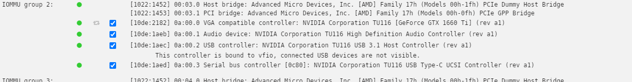

The passed through GPU in question from System Devices:

Ok so found what the problem was. I already have the VM GPU passed through in the vfio.
Removed the 4 devices I had to pass through in that IOMMU group from the syslinux configuration (and from System Devices). Rebooted. Played around with ACS override to see what would work.
In the end I could pass through the GPU without needing ACS. I only needed to manually add each of the 4 devices in that IOMMU group to the xml for the VM. Maybe could have been separated more but it's preferred to not use ACS if I don't have to.
The multifunction lines in the xml were numbered 1 (video), 2 (audio), 3 & 4 (USB controller). There were 4 devices as part of the GPU multifunction.
Now both GPUs are visible to the Nvidia Drivers plugin on startup so 'nvidia-smi -pm 1' can be used to stop the fans spinning, which is now on a script running every 15 mins.
When VM is in use, it disappears from the Nvidia Drivers plugin. VM stops and it appears again. The script doesn't impact the VM GPU as the Nvidia Drivers plugin can't see that GPU.
