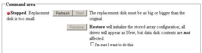

unraid tells me that the new disk (which is in fact the old disk) is to small.

Would
  • Leaving the 1TB disk in the array.
  • Replacing the parity drive by the 1.5TB drive. (Thus restoring the old configuration)
  • checking "I'm sure I want to do this" and hitting "Restore"
be the right thing to do?
I guess I'll have to tell unraid to resynch parity after that.

You outlined the steps exactly.    You'll not have to tell unRAID to re-sync as pressing the button labeled as "restore" will immediately invalidate your parity data.  It will automatically start a new parity calculation when you next start the array.
Joe L.

Am I right that the procedure would be different if I had already updated to 4.7? I seem to recall reading something about the Restore button being removed and a shell script (initconfig or something along the line) took it's place.
myce
Thanks.
myce
Correct.  And in the 5.0beta4 there is now a "New Config" utility screen to perform the same step of setting a new configuration.
It says:
This is a utility to reset the array disk configuration so that all disks appear as "New" disks, as if it were a fresh new server.
This is useful when you have added or removed multiple drives and wish to rebuild parity based on the new configuration.
DO NOT USE THIS UTILITY THINKING IT WILL REBUILD A FAILED DRIVE - it will have the opposite effect of making it impossible to rebuild an existing failed drive - you have been warned!
