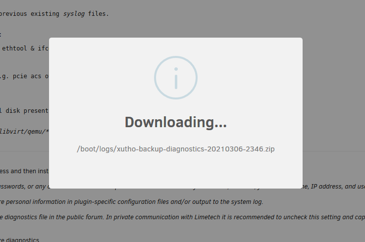

March 8, 20215 yr Author So now after nothing worked well even rsync to this server i used the downgrade to 6.8.3. immediately after reboot all is working fine shares are working also export diagnostic settings. So i did the upgrade to 6.9.0 again and now all is working? It seems the first update was going totally wrong. xutho-backup-backto-6-8-3.zipxutho-backup-6.9.0.zip
