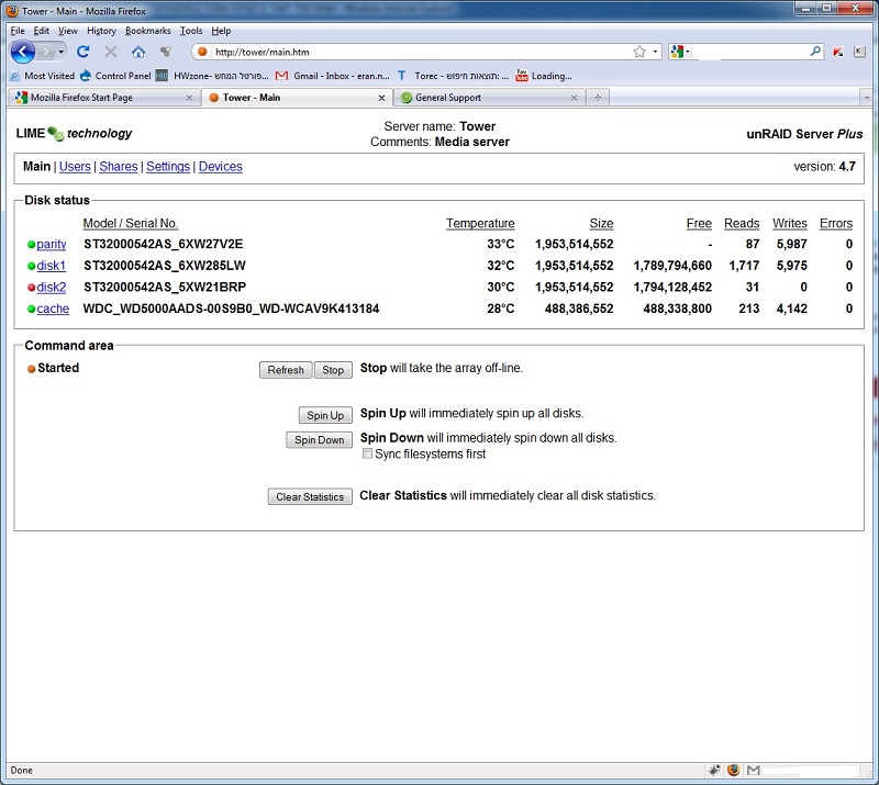

Red dot in new hard drive (less then a week). what does it mean ?
Hi ,
I have 4 new hard drives in my nas box , 3x2TB and 1x500GB for cache.

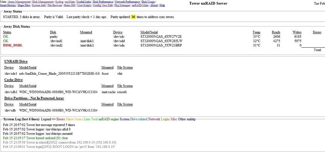

Today after i did poweroff from terminal I've seen that one of the 2TB drives (mnt/disk2) has red circle.
What could be the problem here ?
Attached 2 images of main and unmenu and syslog.
thx.
syslog-2011-02-15.txt
unraid screenshot
It indicates a "write" to the drive failed and it was taken off-line.  (disabled)
There can be many causes, anything from the drive itself failing to a cable failing, to a loose connector.
See here for a starting point:
http://lime-technology.com/wiki/index.php?title=FAQ#What_does_the_Red_Ball_mean.3F
Do not be fooled by the ability to read and write the failed drive.  It is being simulated by reading all the other remaining disks in the array.
First steps would be to stop the array, power down, and re-seat the connectors to the drive.
Then, power back up, and see if you can get SMART Status reports from the drive. (you can use the unMENU disk-management screen to make that easy)
If the disk responds with a smart report, odds are it was only a loose connector.
You'll then need to stop the array
un-assign the failed drive
start the array with it un-assigned  (this will cause the array to forget its model/serial number)
stop the array once more
re-assign the drive
start the array and allow it to re-construct the contents onto the failed drive.  This will typically take 8 to 10 hours for a 2TB disk. (about the same time it took for the initial parity calc)
Once the disk is re-constructed, click on the "Check" button to ensure you can read what was just written.  If that parity-check is successful, you are back running.
If by chance the disk had actually failed, you can stop the array, install a replacement disk instead of the old, and then just start the array. It will re-construct the old contents onto the replacement drive.
Joe L.
