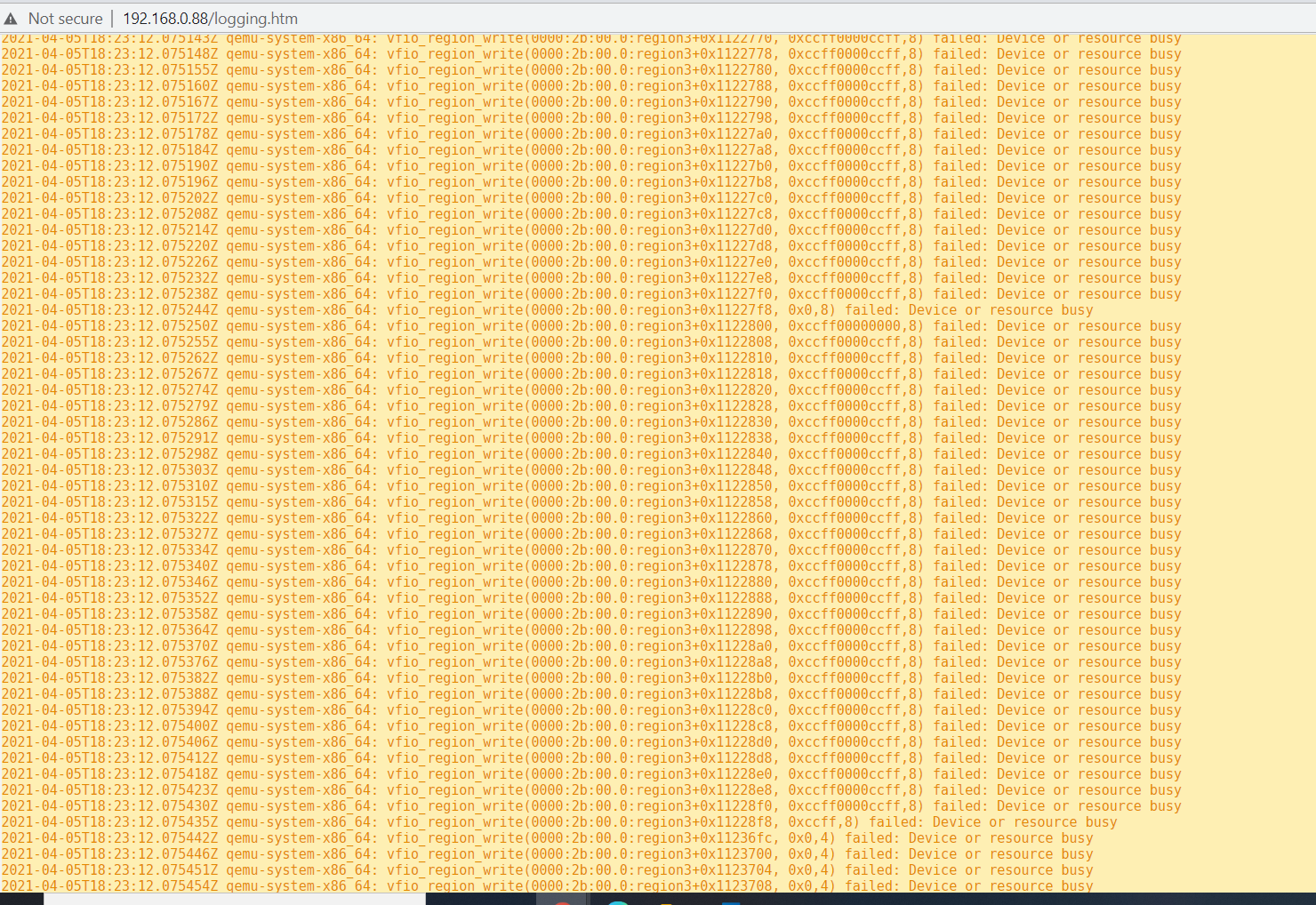

When starting up a VM (Win10 in this case) bellow is the error im getting on the log. (Screenshot also attached)
This is the error code in the log (Log Screenshot Attached)
2021-04-05T18:23:12.073130Z qemu-system-x86_64: vfio_region_write(0000:2b:00.0:region3+0x111d780, 0xccff0000ccff,8) failed: Device or resource busy
2021-04-05T18:23:12.074649Z qemu-system-x86_64: vfio_region_write(0000:2b:00.0:region3+0x1121708, 0x0,8) failed: Device or resource busy

Hopefully, you've figured out a solution by now, i.e. went back to using legacy boot. I'm not sure how your setup is intended to work, but it appears Unraid couldn't passthrough your GPU because it was already allocated to the GUI. That being said, I myself started using Unraid last year and have never booted into GUI mode, so am not sure why you do. I would suggest two solutions for you:
1) Stop using GUI mode. Use legacy boot and control your Unraid system through a web browser running on a local device on your network. This is how most people appear to use Unraid. If you don't have access to a laptop, 2nd desktop, etc, you can probably get away with using a phone connected to the same wifi network, at least for startup. Afterwards, you can technically manage Unraid through a web browser within a VM.
2) If you really need to access Unraid through the GUI for whatever reason, you'll probably need to put another GPU in the primary PCI-E slot for GUI mode to boot to and run off. This can be a cheap, low-end GPU.

The only reason I stumbled upon this page was because I encountered the same "...qemu-system-x86_64: vfio_region_write(...) failed: Device or resource busy" error. Reading this post, helped me troubleshoot my own problems. My motherboard detects two boot options on my Unraid flash drive, a legacy one and a uefi one. Turns out I switched the boot order/preference after messing around with some settings in the motherboard bios. So, if anyone happens to stumble upon this page in the future, running a single-GPU system with passthrough to a VM and all of a sudden encounters this error, try clicking your boot device on the Main tab and make sure "Server boot mode" displays "legacy". Spent several hours troubleshooting my system until I came across this post, thanks!
