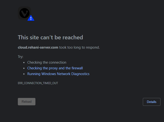

Now, I have a static IP address set for the unraid server on my local network and I've gone through/re-followed every step (changing IP addresses to the new static IP address wherever applicable). I am able to access the nextcloud server through my mobile phone on data for instance, but not through my local network. No other device on my local network is able to connect to the Nextcloud site (either through a web browser or through the desktop application).

Specifically, here is the timeout I get on browsers locally:

I was able to resolve this by transferring my reverse proxy validation method from HTTP to DNS following SpaceInvaders video. This resolved at least some of the issues, as I can now access everything by the URL (just not by the IP address quite yet)
