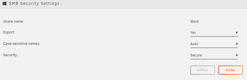

Many thanks codefaux for the fast response! Yes i use SMB Shares with the settings in the photo. Because my experience with unraid stops here, where can i find all this logs so i can take a look? If i cant find anything i don't mind sharing the logs here so we can find a solution. Many thanks in advance.
