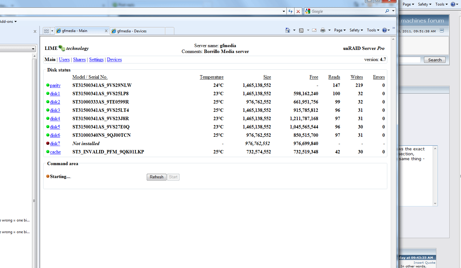

Ok, update:  stopped the array, powered down, unplugged cable (power and sata) powered up, and it shows the exact same thing - disk is "Not installed".  When I stop the array (it started automatically), and go to the drives section, obviously there is no option to select it since it is not connected.  Then I start the array and it shows the same thing - Disk not installed.  Screen shot attached.
