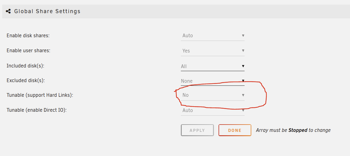

August 5, 20215 yr Author nevermind, i understand now, only lower case files will be visible and if share already exists there are most likely files that are not all lower case. yeah smb performance really sucks in 6.8.x and onward compared to 6.7.2 which seem to be the last version that had a smb protocol that didn't add seconds of delay between accessing a file EDIT: This setting fixed my smb speed issue in 6.8.3 and onward (Default is yes, set to no to speed up smb directory listings) Not sure what i would be losing out on with this disabled, i don't use any hard links that i know of. Edited August 5, 20215 yr by je82
