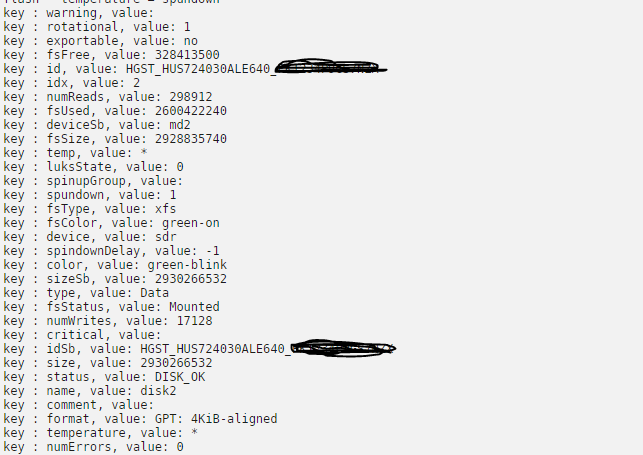

Managed to pull out the temp param ๐Ÿ™‚
ย
sed -nr "/^\[\"disk2\"\]/ { :l /^temp[ ]*=/ { s/.*=[ ]*//; p; q;}; n; b l;}" /var/local/emhttp/disks.ini
ย
Looking very promising and cutting out checking for idle etc as can just pull temp direct from that and a chunk of additional complexity in needing to pull from HDDTemp to work around various SMART formats as have mixed drive models.

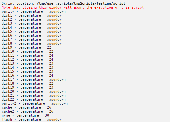

So thought it would be good to share progress.
First time writing bash script so probably a little crude.
Have gotten as far as pulling array of disks from disks.ini along with an array or parameters for each disk and outputting a list of disks with either their unraid temp or 'spundown'.
Open to any advice or amendment suggestions.

##GET LIST OF ARRAY DISKS
declare -a diskList
while IFS='= ' read var val
do
    if [[ $var == \[*] ]]
    then
        section=${var:2:-2}
        diskList+=($section)
        eval declare -A ${section}_data
    elif [[ $val ]]
    then
        if [[ $var == "temp" ]]
        then
           eval ${section}_data[temperature]=$val
        fi
        eval ${section}_data[$var]=$val
    fi
done < /var/local/emhttp/disks.ini
##CHECK DISKS
#echo disklist
for disk in "${diskList[@]}"
do
    checkedtemp=0
    temp=${disk}_data[temperature]
    if [[ ${!temp} =~ ^[0-9]+$ ]]
    then
        checkedtemp=${!temp}
    else
        checkedtemp=spundown
    fi
    echo $disk - temperature = $checkedtemp
done
