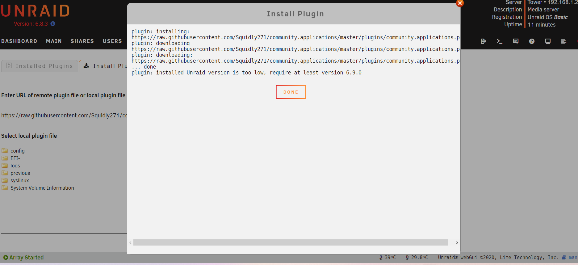

Unfortunately after rolling back I had no dockers and no CA plugin.
I did assign my cache drives again and dockers are back now, but
I cannot install CA plugin which requires at least version 6.9.0 of unraid.
So what now? Any ideas?

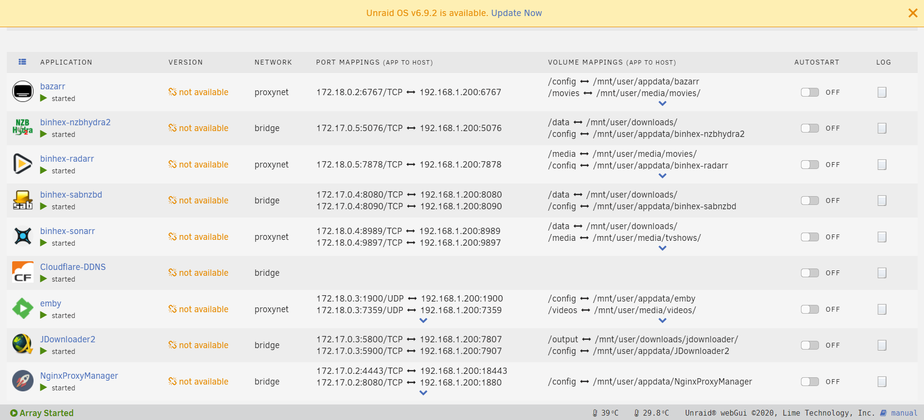

Also if you get a error saying updates are not available for your packages, add this to your go file
sed -i 's#@Docker-Content-Digest:\\s*\(.*\)@#\@Docker-Content-Digest:\\s*\(.*\)@i#g' /usr/local/emhttp/plugins/dynamix.docker.manager/include/DockerClient.php

It helped with almost all dockers, but one app - bazarr still shows update not available.
I'm attaching screenshot.
Any ideas? Maybe I should reinstall bazarr?

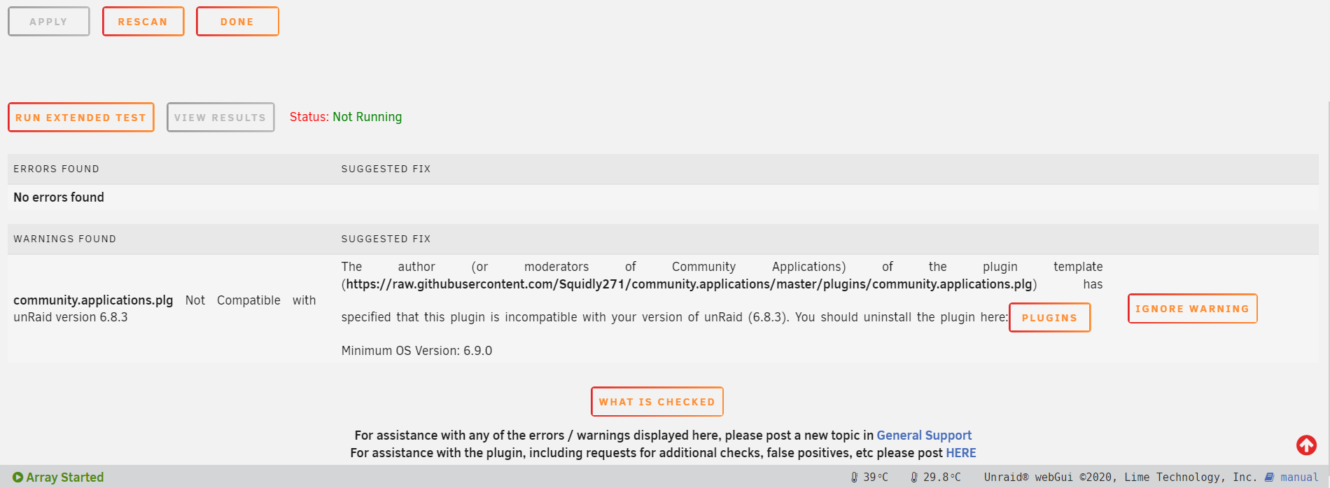

And another problem came up - Fix Common Problems is alerting about this:
Should I just ignore that warning?

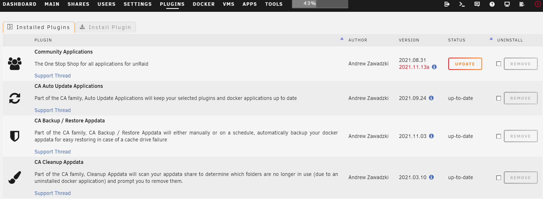

... and in Plugins I can see big "UPDATE" button:
... just ignore it or try to upgrade? (which will probably fail due to unraid v. 6.8.3.

Yeah ignore and dont update,

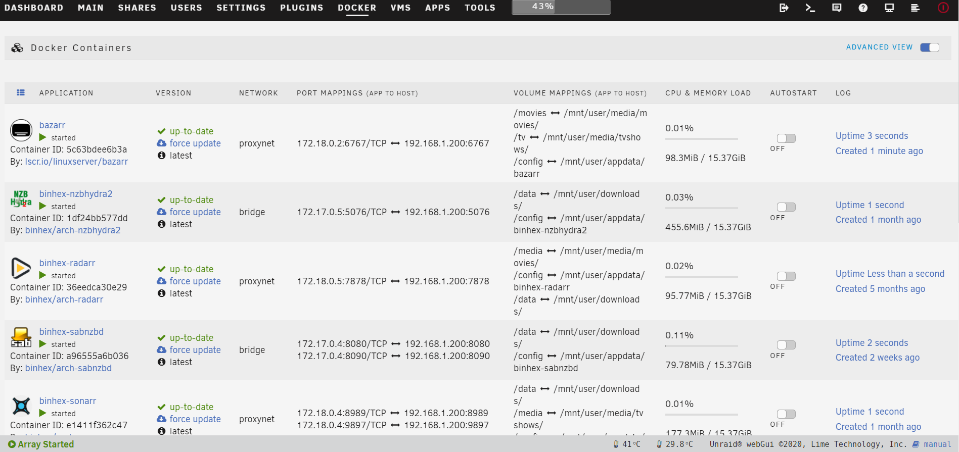

You were right. Force updating fixed it:
Thank you very much for your help.
