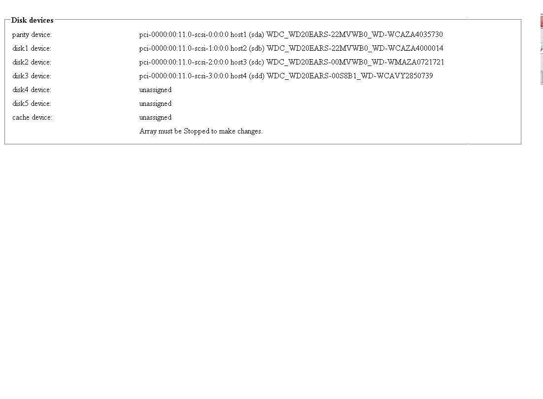

But in the Web UI, the parity drive is listed as sda:
parity device:  pci-0000:00:11.0-scsi-0:0:0:0 host1 (sda) WDC_WD20EARS-22MVWB0_WD-WCAZA4035730
Very interesting indeed.
Please attach a system log to this thread.  (and a screen shot of the web-UI too if you can)
There is an inconsistency in the display, that's for sure.
The good news is that unRAID does not use the device name, it uses the PCI ID () in 4.7, and in the 5.0beta6a version, it uses the model/serial number of the disk itself.  (The device names can change from one boot to the next based on the initial spinup time of each disk and when it announces it is ready to the OS in the boot sequence)
Here's the screenshot and syslog:
