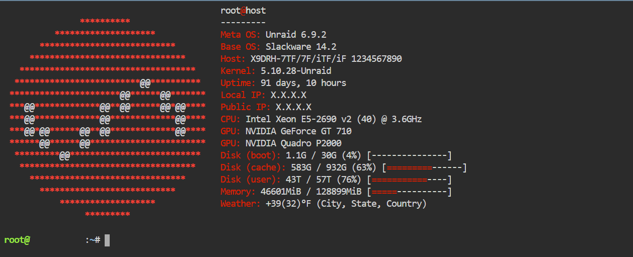

December 8, 20214 yr I installed the "neofetch" application using the Nerd pack but was bummed to see that Unraid wasn't supported as a detectable OS. I couldn't find one anywhere else, so I created my own: To replicate this you simply need to do the following: Install Nerd Pack from CA Appstore Install "neofetch" package Copy the attached "config.conf" and "unraid_ascii.txt" to ~/.config/neofetch If you want this to display automatically at login, add the line "neofetch" to the bottom of ~/.bash_profile unraid_ascii.txt config.conf Edited December 8, 20214 yr by sdub
December 15, 20214 yr At least on my system, the correct path is /root/.config/neofetch Really cool though I like all the added info Edit: Nevermind, both pathings work Edited December 15, 20214 yr by Antibios
December 13, 20241 yr Sorry to necro an old post, but to build on this; The /root/.config directory lives in RAM and does not persist through a reboot. To make these changes survive a reboot, I created a directory on my flash (/boot/config/neofetch) and placed config.conf and unraid_ascii.txt there. I then created the following userscript; #!/bin/bash mv /root/.config/neofetch/config.conf /root/.config/neofetch/config.conf.bak cp /boot/config/neofetch/config.conf /root/.config/neofetch/config.conf cp /boot/config/neofetch/unraid_ascii.txt /root/.config/neofetch/unraid_ascii.txt and set it to run at first array start.
