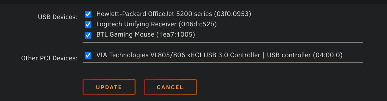

HI, I have this problem, when I pass throught a usb pcie card the vm doesn't boot
I tried replacing with another one and I tried all pcie slot, it's seems it has boot priority 0, even without nothing connected
This is my xml:

And this is my configuration:
