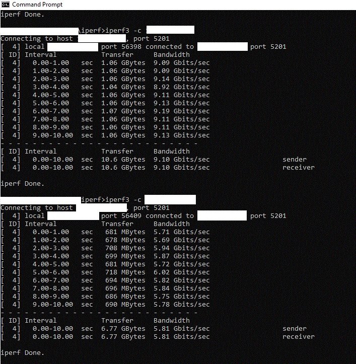

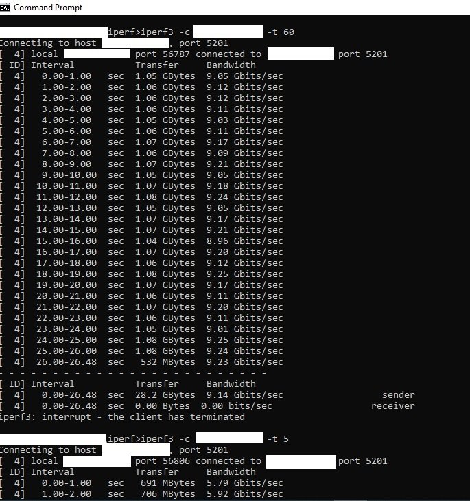

Technically, I should be able to easily saturate the 10 Gbps link ( 1250 MB/s ) writing to cache but it seems that my write speed is capped at around 500 MB/s. Naturally, I started by investigating the network link between client and server using iperf3 and found out that most of the time the average speed is between 5 to 6 Gbps but occasionally it would hit 9 Gbps. I would say it hit 9 Gbps in 1 out of 10 repetitions. Please refer to attached screenshots. There was one test with -t 60 parameter and it was running consistently at 9 Gbps but as soon as I ended that test, the next one was back to 5 Gbps.
Have anybody experienced this and know what caused the issue?
Update: I found out that with the default's window size, iperf3 would underperform. I added the " -w 1M " flag and now I get consistent ~9 Gbit/s link speed between client and server. Now I know that link speed is fine but the problem of ~600 MB/s write speed cap is still there (update: after further test, the average write speed cap is ~600 MB/s, not ~500 MB/s as stated in my first post). Does anybody know where to tinker around?
