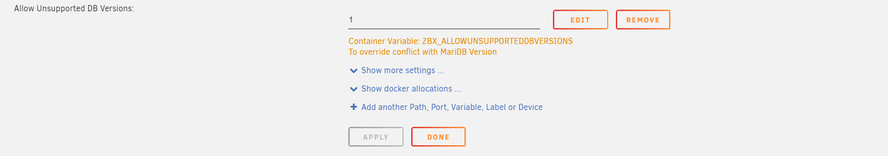

If you Edit the config of your Zabbix Dicker, you have to create a new Variable (I attached a printscreen). You can give it a friendly name like I did but the variable name has to be:
ZBX_ALLOWUNSUPPORTEDDBVERSIONS and the value 1.
Hope this helps. I know you got it work but just in case you wanted to know.
