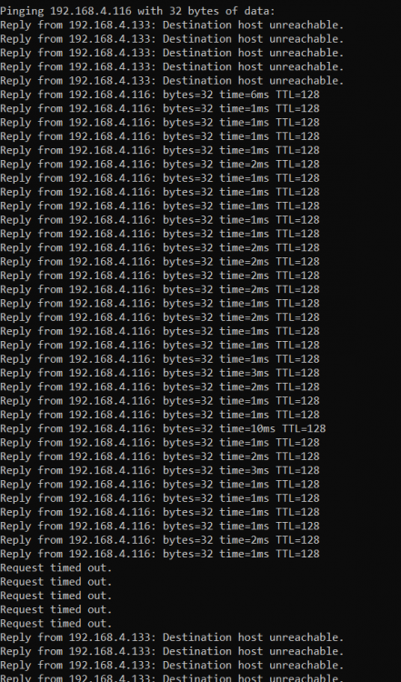

When I got to the sections of setting up my nVidia GPU, this is where I hang, and I cannot find an answer to what I am experiencing.
When the VM GPU is configured VNC, I have absolutely no issues. I can connect to the VM all day long.
When I change the GPU to the nVidia GPU, set the vbios to the bios I downloaded following Spaceinvader one's vbios download script, and assigning the matching sound card on the GPU...i get no where. Cannot ping the VM. The network does not come up, at all.
I confirmed this by running a ping -t from my laptop to the VM after switching back to VNC GPU, removing the sound card, etc. I can load the VM in VNC, but the continuous ping fails until I login to the VM, and only after I login is the ping successful.
It looks like, to me, that when I change the GPU, the network fails.
I have no idea what is happening and any help is appreciated.

Every time I attach the GPU to the VM the network drops out. Period. I have statically assigned the IP in the VM. I am using PiHole as an DHCP server and reserved the IP in PiHole. My UDM Pro see the VM on the network with the correctly assigned PiHole IP address.

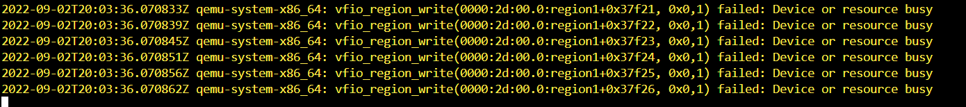

The VM shows this log

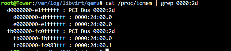

output of cat /proc/iomem

I got it. I was missing one configuration.
My system only has the one gpu. I forgot to add the configuration that forced unraid to boot without gpu.
Once I put this setting in, everything worked.
I understand why this setting is required. What I don't understand is why not having this setting was causing the vm on the network to crash.
Because you didn't have loaded windows. Windows doesn't boot without gpu....  The thing is that most of this videos are not relevant anymore. A lot of things change.
The thing you have to do for the gpu to not been used by unraid and to be bind to vfio driver is. Unraid GUI>TOOLS>System Devices>mark the check box of the device>click on bind to vfio>reboot.
