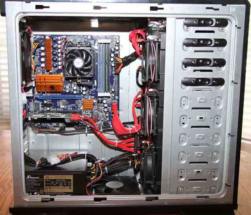

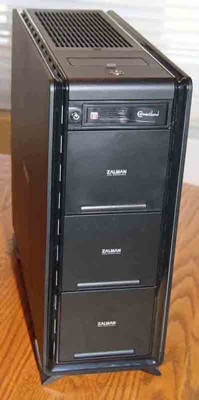

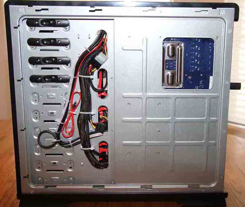

Incrementally assembled everything over a two week period.  Has worked like a charm since day one.  I have it sitting behind one of the doors to my den and you can only hear the system when you are standing right next to it - a gentle sound of air moving.  The only issue I had was I experimented with removing and replacing a HD.  Hit the rebuild button and began wiping out the data.  Lurked some more and found the issue - won'd do that again (I hope).  I do have all backed up on external harddrives so only time was lost.  Currently have about 1000 DVDs (movie only) on the server.  Still need to load up my BlueRays, TV series, music and photos.  Attached are photos of my assembled system, the front inside and back inside.

It only appears easy - the result of extensive reading in this forum, being an EE (14 years since I've done anything technical), working with computers since 1967 (programing in HS) and working late depriving myself of sleep.  However, this was the first time I decided to dress the cables since I don't think I will be opening the case again any time soon.  Additionally, all the contributors on this site set the bar pretty high in terms of making their systems look professional or better.
