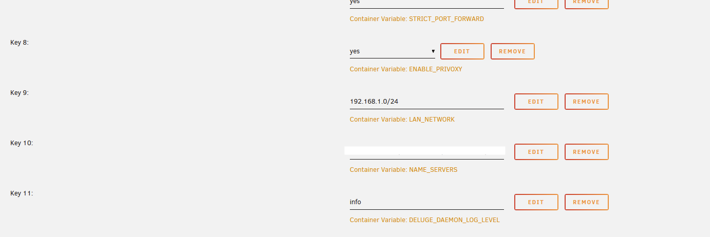

One of the DelugeVPN Settings is the “Container Variable: LAN_NETWORK”, so maybe that's why it was working before:
I have tried to add under “Name_Servers” the IP of my Adguard Home, but it didn't work.
