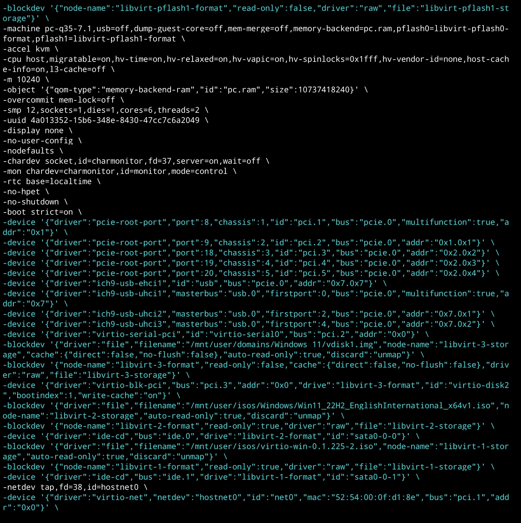

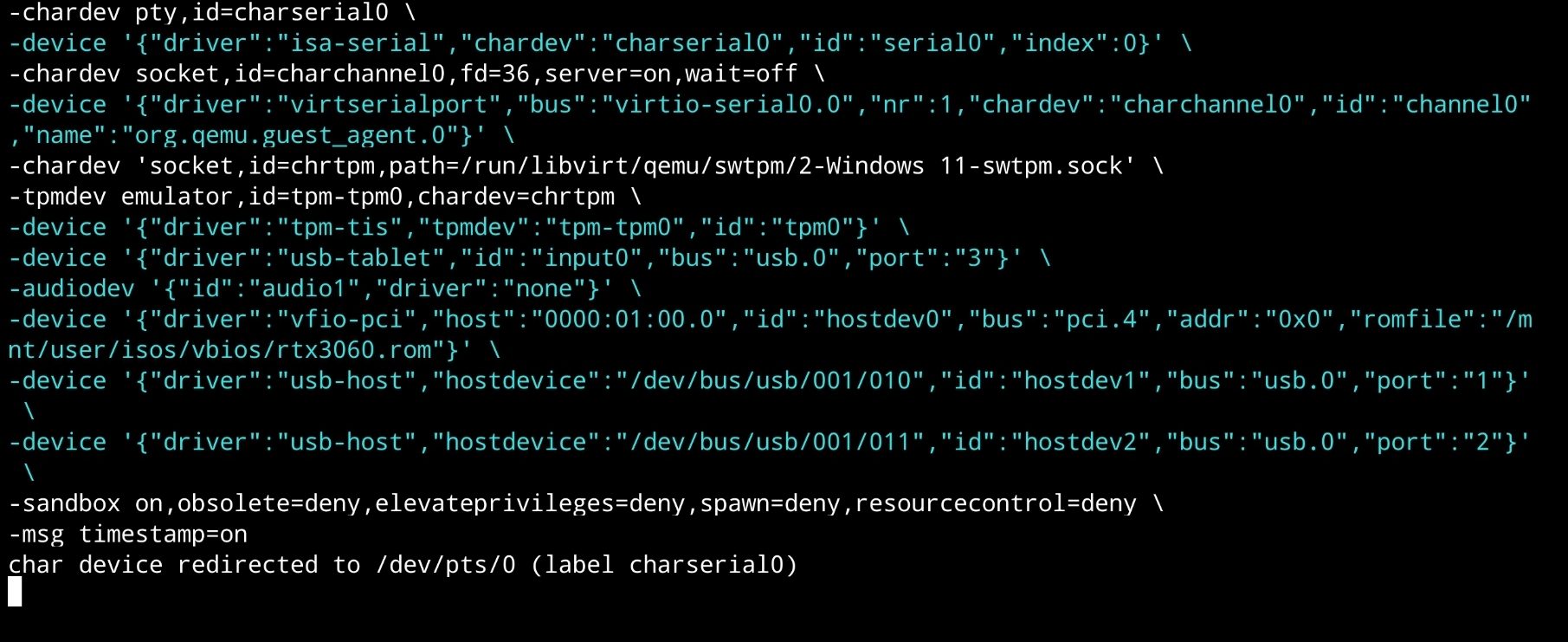

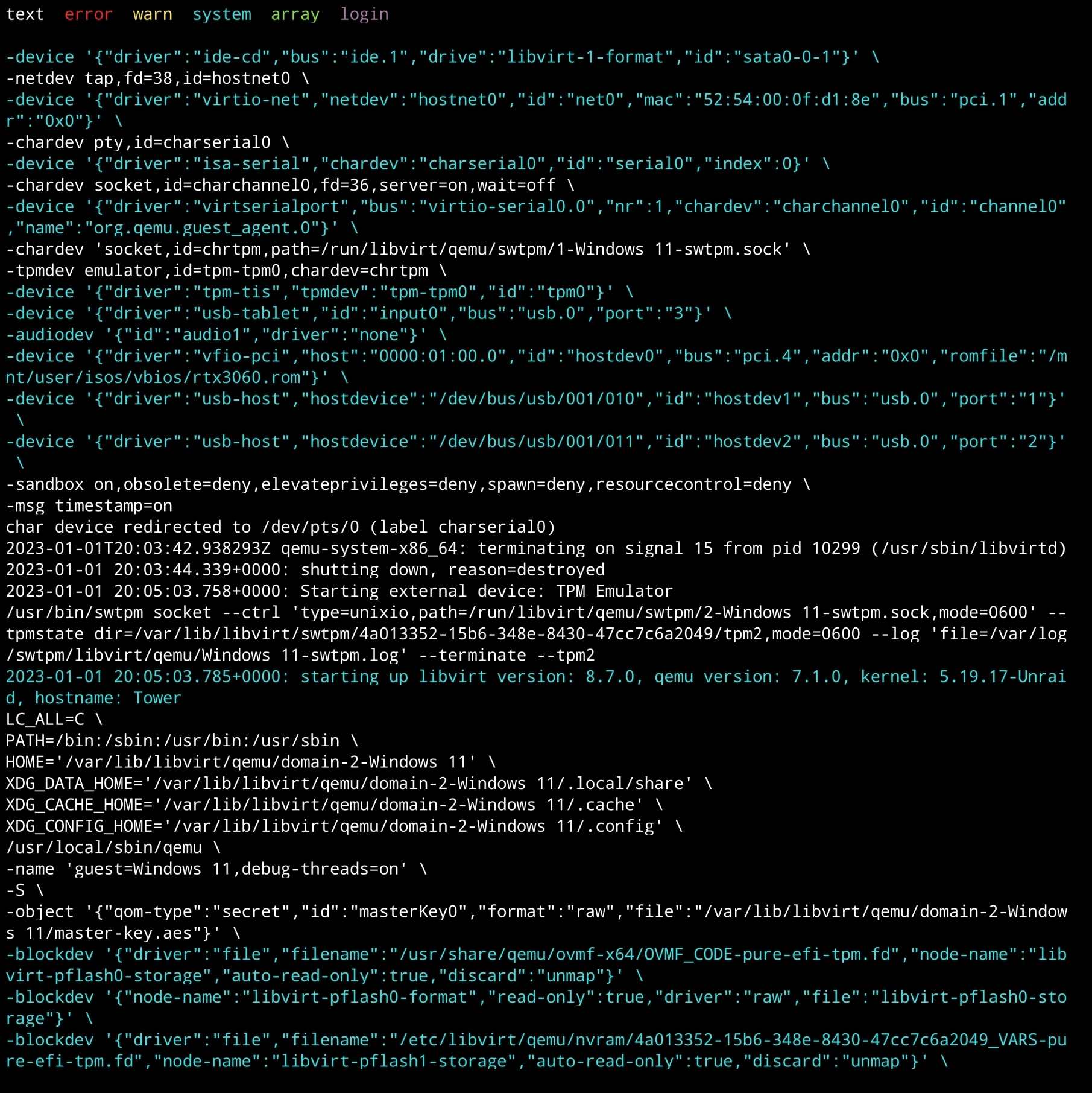

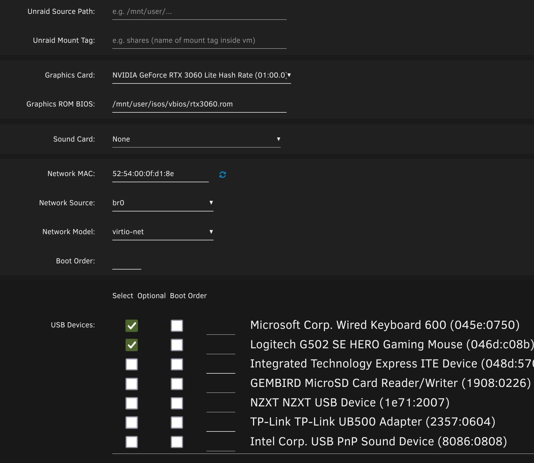

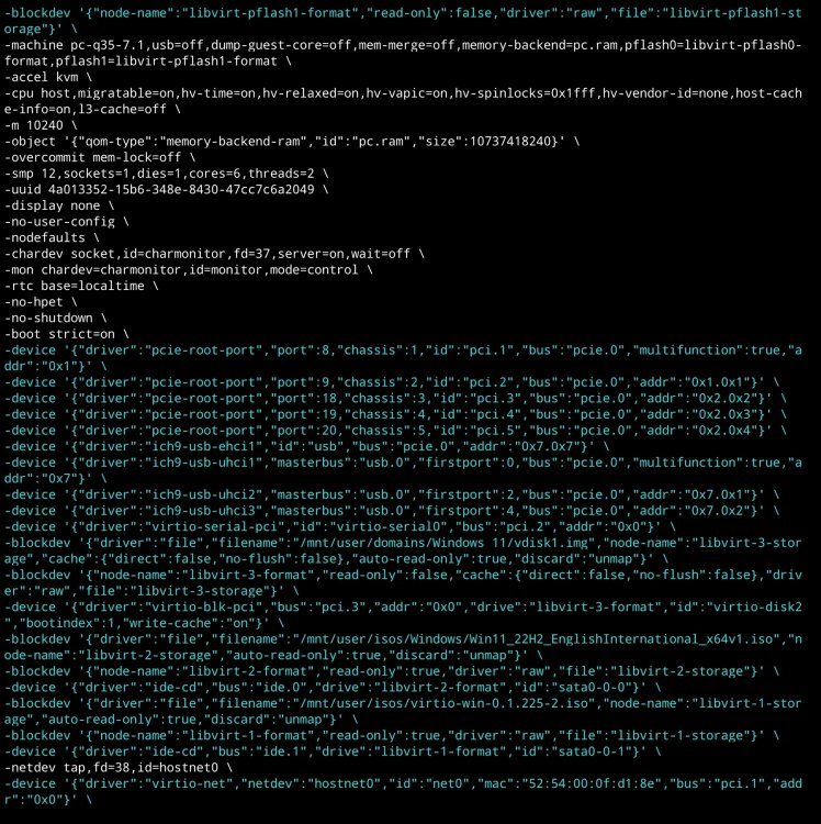

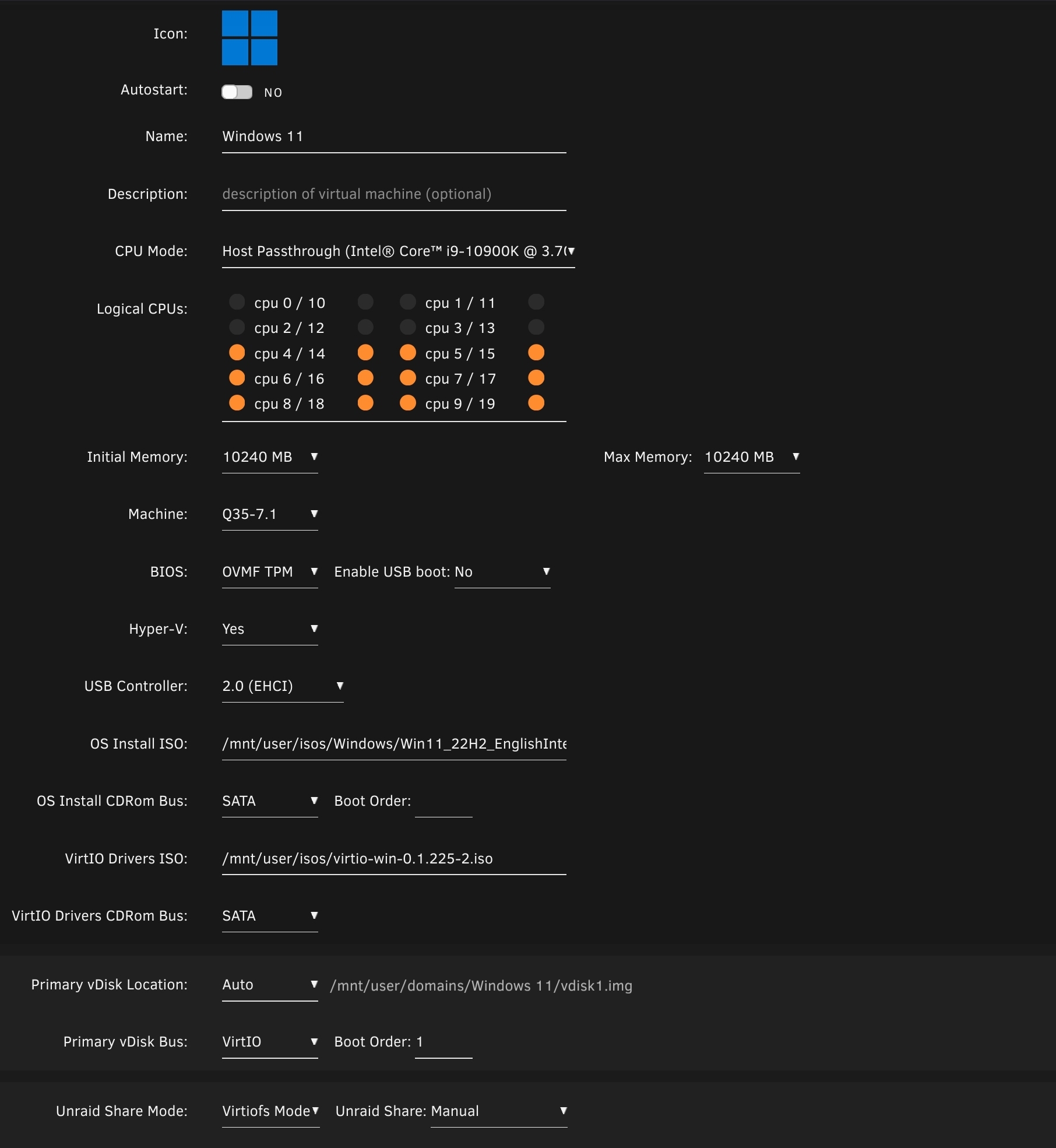

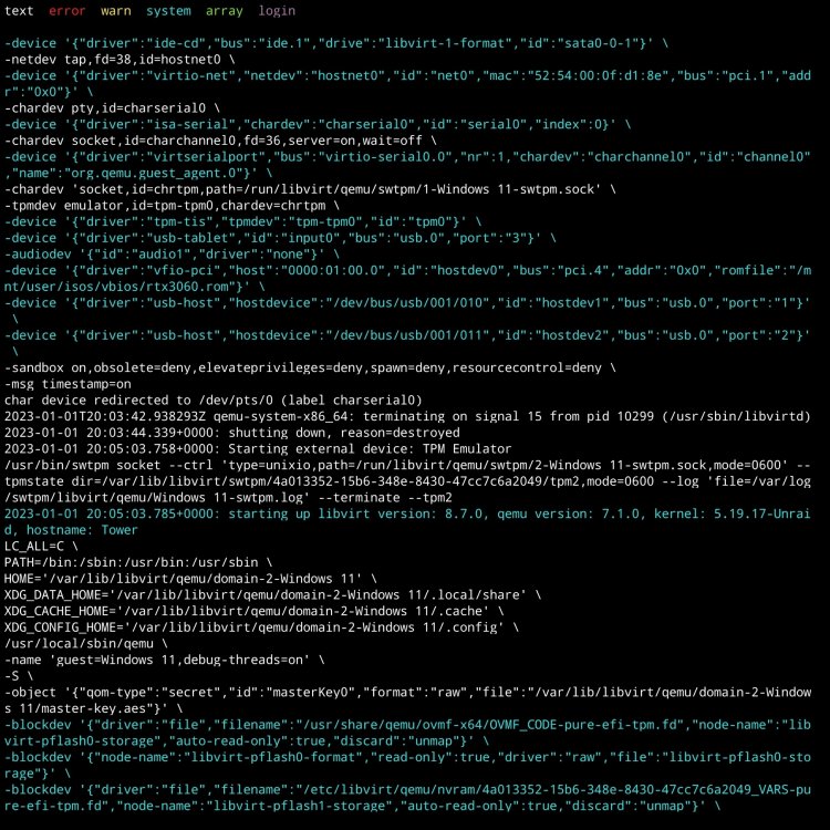

I have attached screenshots of the VM template and the VM log. I can provide the system logs if they are needed.

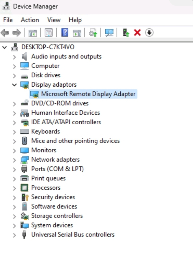

After endless reboots, I read on another topic that the on board Nvidia audio also needs to be bound in the VM template otherwise that can cause issues, so I have done that and rebooted the server. On a side note, I initially stopped binding the audio as I thought that was causing the issue in the first place. Anyway, the VM now boots, but I can only access via RDP as the 3060 is not showing up in the Device Manager.
1748557717_Screenshot_20230101_204127_MicrosoftRemoteDesktop.thumb.jpg.7b335c6d1f1b705e67c25a6b68fefce8.jpg

Can you post the VM's xml?

Thanks for the suggestion.
After many hours I finally tried i440fx-7.1, that finally did the trick and the VM seems stable so far. Fingers crossed it remains.
