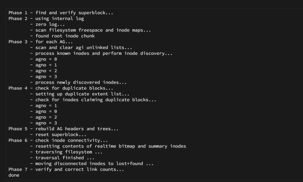

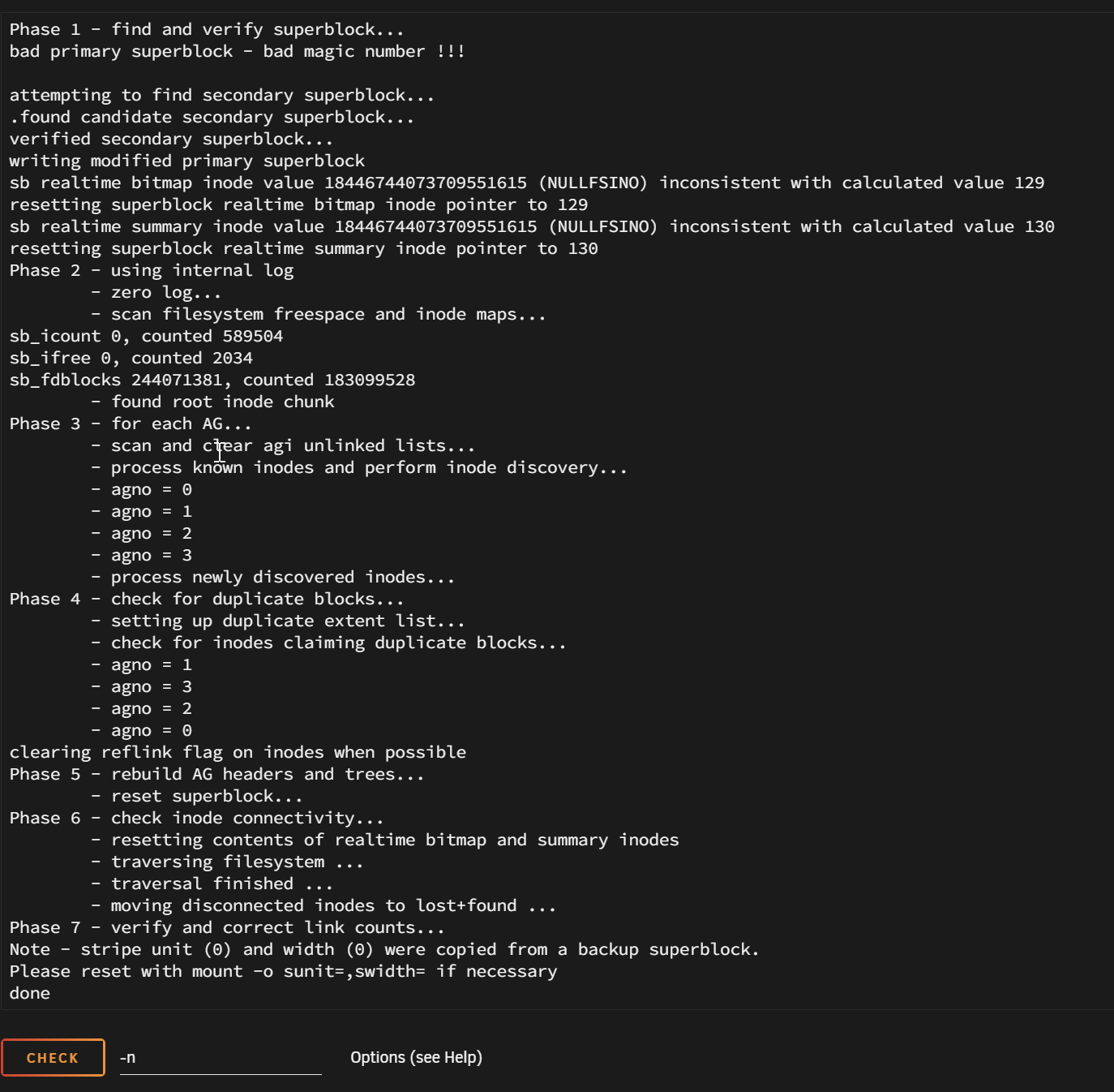

I ran xfs_repair with the following results:

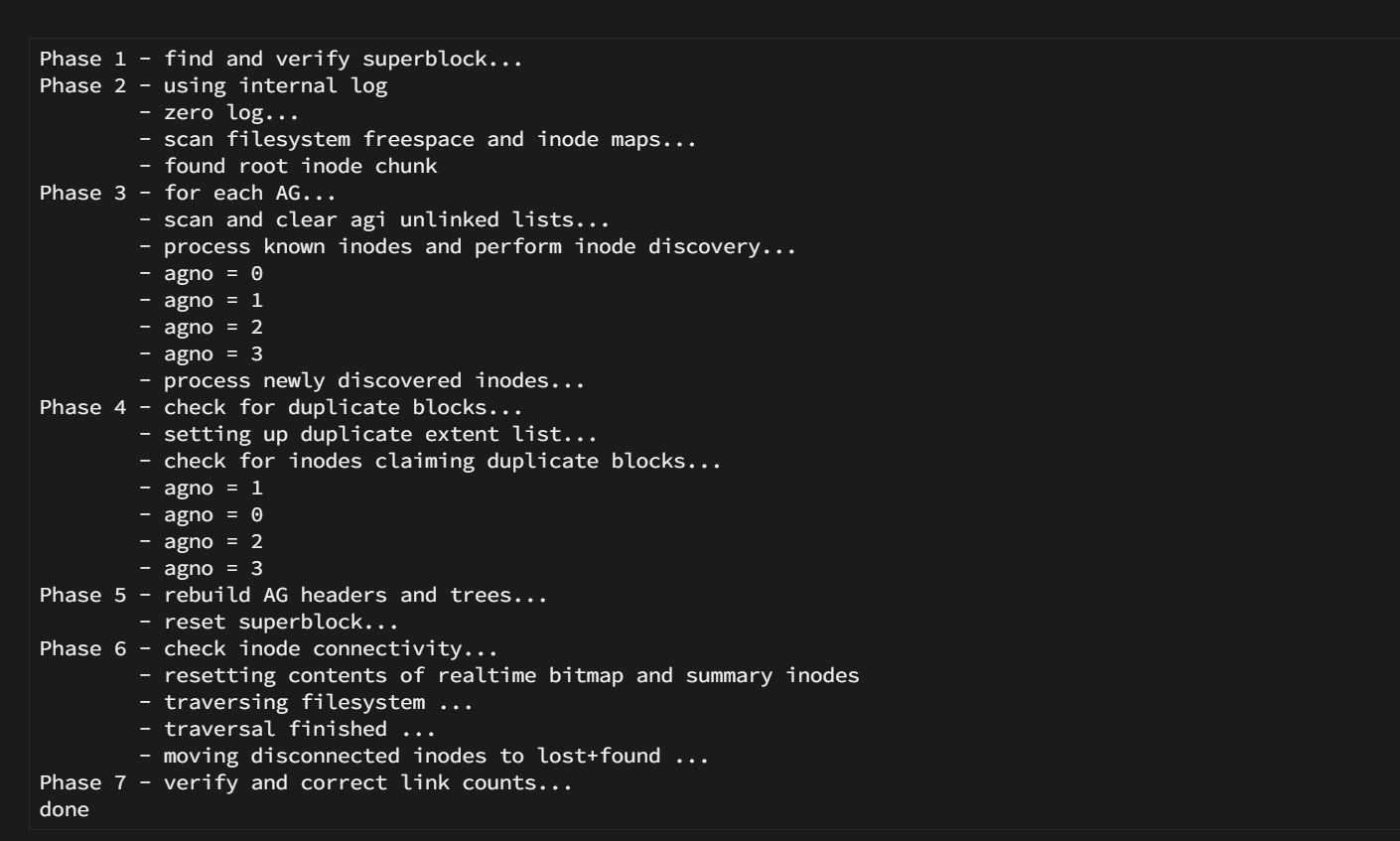

Solved this (maybe by accident). Mounted using the above, then used xfs repair again (with the same outcome as above). Started the array and the drive mounted with original files intact.
