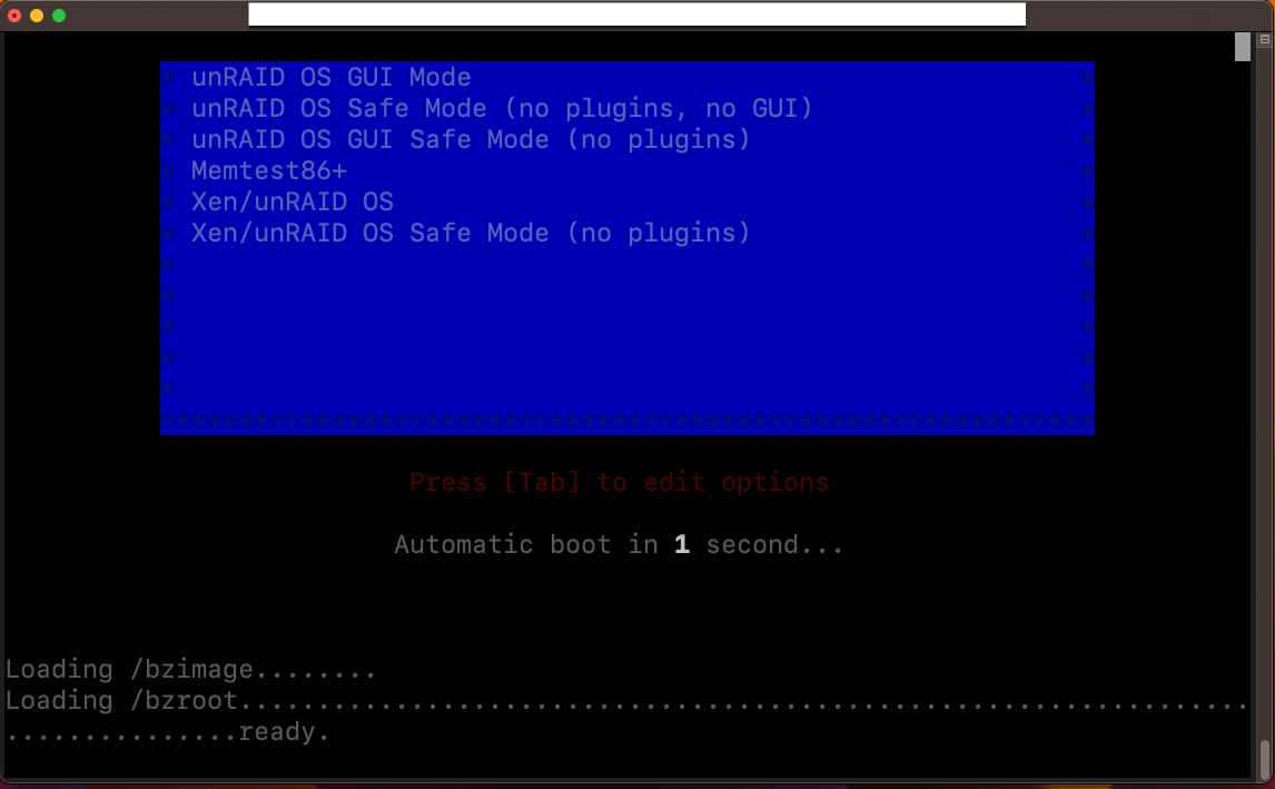

So far it has been working great however at the moment I am only seeing the bios side of things, meaning that if I boot the server while viewing the redirected output using SOL/ipmitool then I only see the bios related messaging and the boot menu options.  Once the boot countdown starts and Unraid boots then there is no further output that I can see.

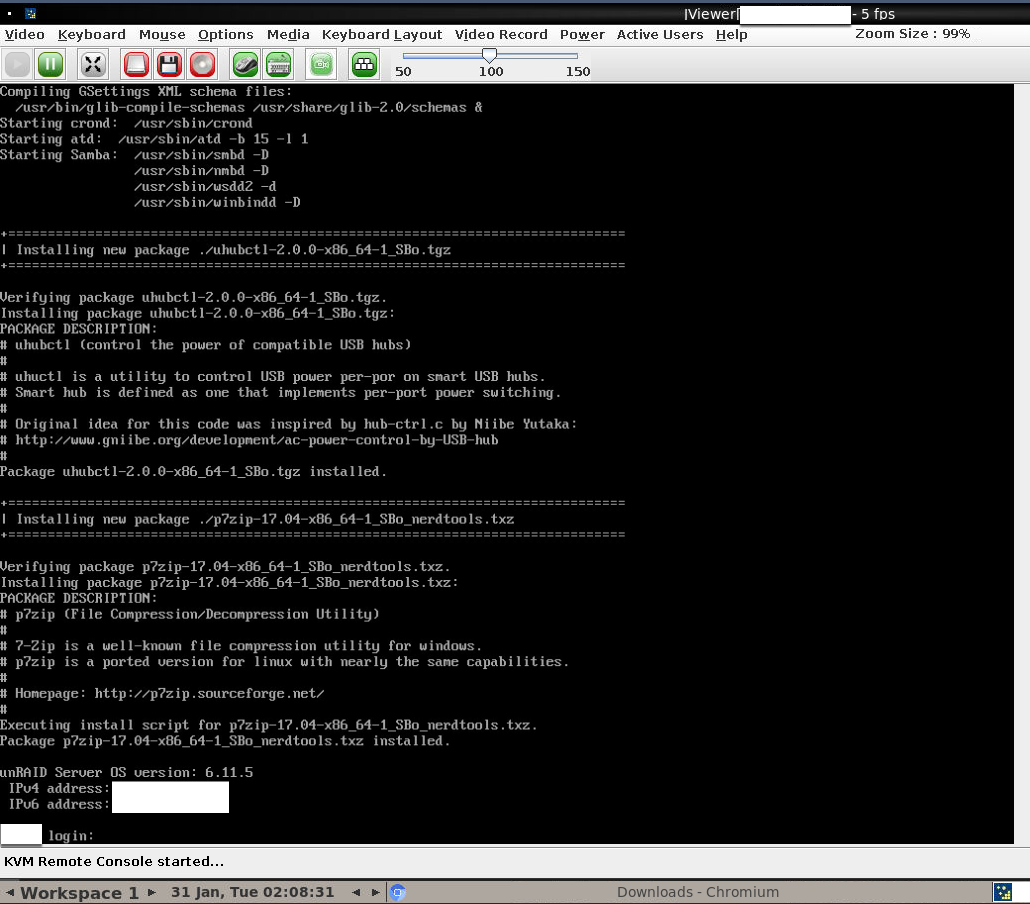

In the meantime I found another option which is by using a docker container to run the IPMI Java viewer applet.  With this approach one can avoid mucking up their own desktop in order to get this abomination to work.  A preconfigured docker for this task already exists and I was able to confirm that it works for my setup: https://github.com/solarkennedy/ipmi-kvm-docker
In this instance the console output is complete, meaning that I can see all the messages that Unraid produces during startup which is useful for troubleshooting a hung (and headless) system:
Now this makes me wonder why the SOL (serial-over-lan) approach only shows up to the boot menu options and stops once Unraid starts the boot process... :
Maybe someone will be able to point out what I am missing here.  The SOL approach is much faster and cleaner so it would be nice to use that method instead of relying on docker containers and abandoned Java applets...
