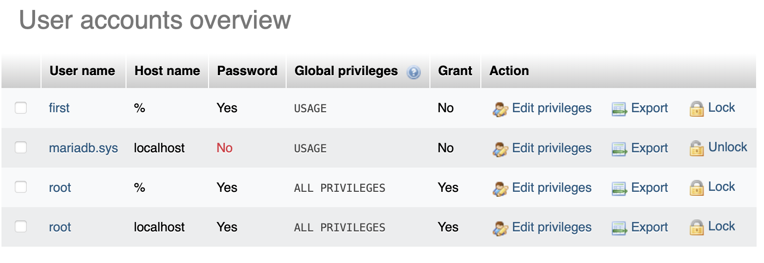

If I go to the `mariadb` User Accounts section, these are the default users in my setup:

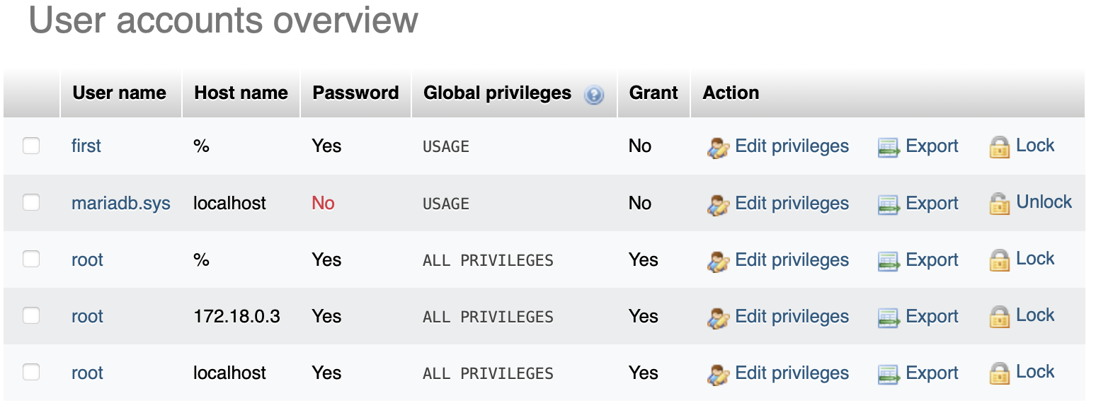

I created a NEW user, with a specific "Host name" entry of the PHPMyAdmin container, 172.18.0.3 (to mimic the log file entry I saw).
Then I redeploy the PHPMyAdmin container to use the `mariadb` as the MYSQL_HOST entry. Retrying the PHPMyAdmin login, which is successful.
Why is the 'root'@'%' not being applied to my authentication, to cover the scenario of `'root'@'172.18.0.3'`? I thought this was the point of this configuration?
