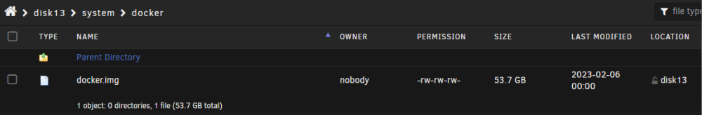

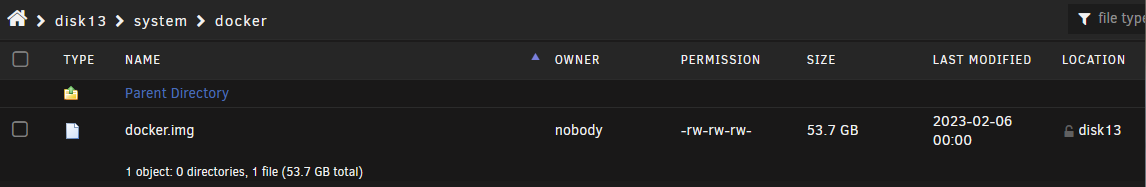

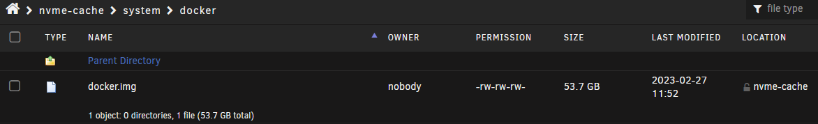

One of the docker.img files is on disk13, the other is in my NVMe cache.
Disk13:
NVMe cache:

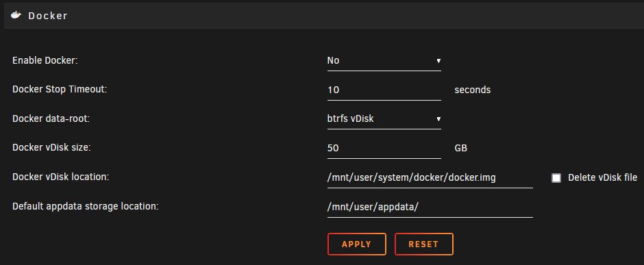

Both of the Docker vDisk files are 53.7GB despite Docker settings being configured for a max of 50GB. The docker image file location is set to:
/mnt/user/system/docker/docker.img

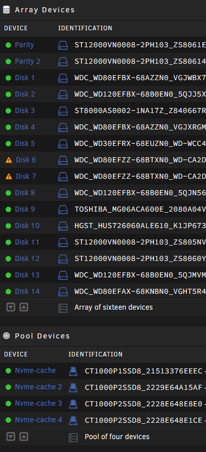

I am in the process of upgrading 2 disks in my array and so the shares that are on that array are marked as "unprotected" while the array rebuilds.
I note that even though /system/ is set to prefer NVMe cache, and even though docker.img is on my NVMe cache, Unraid thinks that it's unprotected because the img file is supposedly existing in 2 locations at once.
How do i correct this issue? Do i just modify the vDisk location and manually point it to /mnt/nvme-cache/system/docker/docker.img then delete the other file on Disk13?

Looking at timestamps, the one one nvme looks more recent. I would simply delete (or move elsewhere as backup while you figure this out) the system share from disk13 if everything it has exists on nvme cache. /mnt/user/system should then pick whatever is up on nvme
This is assuming system share uses the nvme cache
This is normal
Thanks, i'll give it a try. And yes the NVMe cache is a 4 disk array so it's "protected", hence why i noticed the difference between the shares that live on my array and the shares that are using Prefer Cache.
