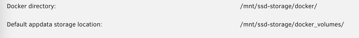

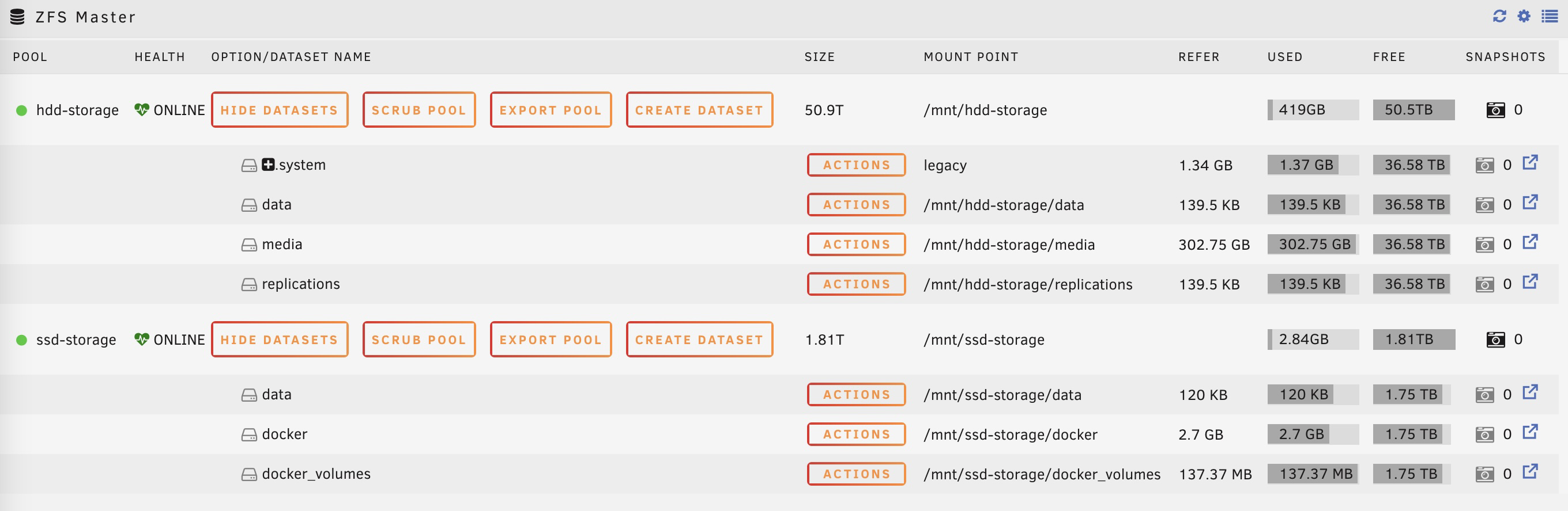

The way you do it in Scale (after disabling their horrible apps and running docker bare-metal) is basically set up a pool (NVME for me) with a /docker dataset and /docker_volumes dataset (appdata I guess). I was able to replicate this in UNRAID after importing my ZFS pools, by setting the docker directory to directory mode and pointing at my existing docker and docker_volumes datasets as shown below. I then installed portainer and everything came right up. I'm pretty sure I could even dual boot into Scale and it would still work since the data structure is untouched (haven't tried, but pretty cool/interesting).

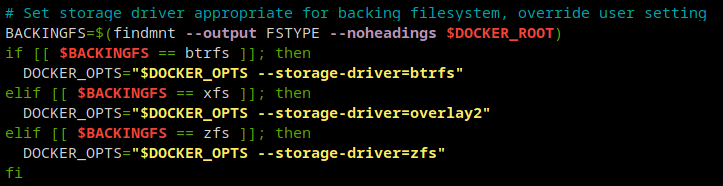

Not sure if you've got anywhere with this, came here googling and ended up figuring out a solution. Unraid sets all the parameters it uses for docker directly on the flags in the service file in /etc/rc.d/rc.docker (symlink to /usr/local/etc/rc.d/rc.docker), which is where it chooses the storage driver:

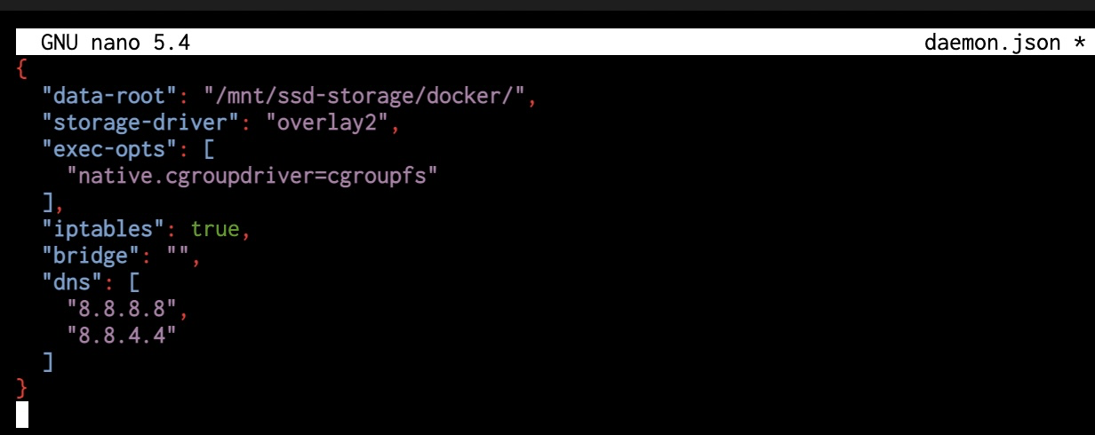

The issue here is that even if you were to persist the daemon.json by putting it in /boot/config and creating a script to copy it back on boot, you'd still not be able to change the storage driver as docker does not allow you to override the flags (and won't even start at all):

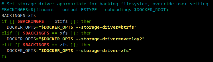

A slightly more practical solution would be to modify the unpacked file during boot, using a script something like the below which you'd execute from /boot/config/go:
# Comment out existing BACKINGFS line, and add BACKINGFS=xfs
sed -i "s/^BACKINGFS=.*$/#&\nBACKINGFS=xfs/" /etc/rc.d/rc.docker
Which results in this, and a happy docker:
