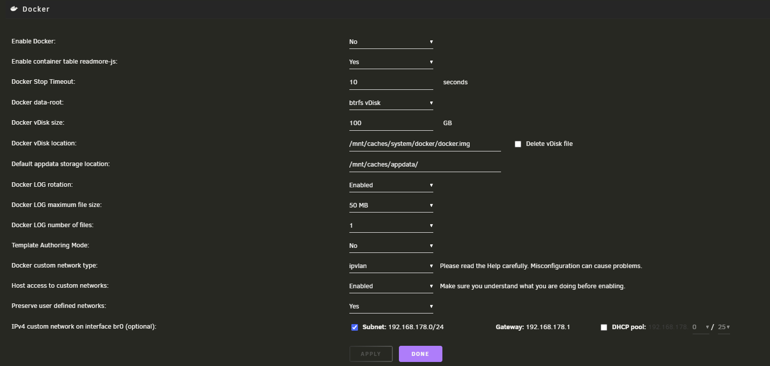

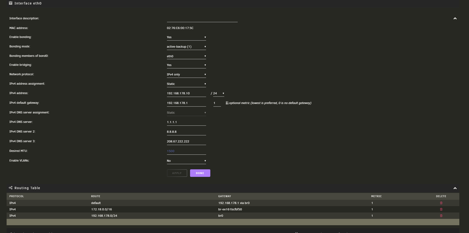

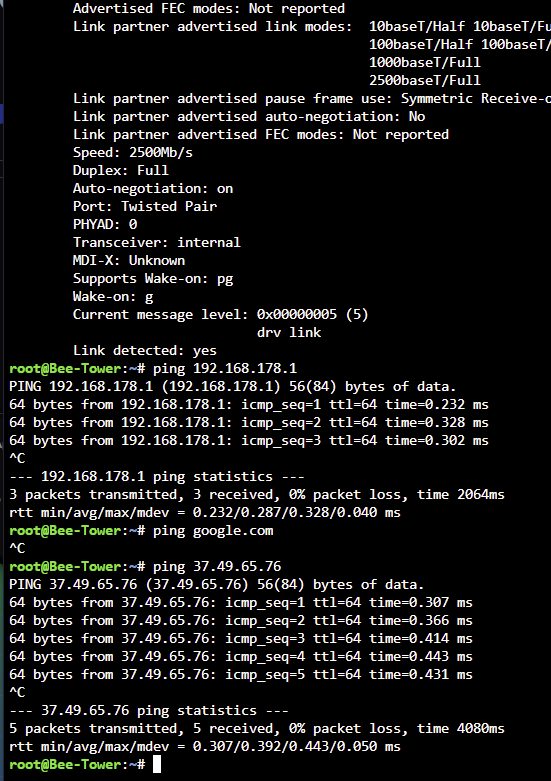

I don't know what to do anymore. I got it working a few hours ago, but somehow it booted up with the wrong IP (I guess I left it DHCP) so when I changed the IP no container could get out and my unraid could ping out either, but oddly enough it will ping the WAN IP.
All this happened because one day I mucked around with the network settings and lost my custom docker network and all my containers wouldn't run unless put on bridge or host.
I'm literally at wits end. I've tried setting default routes and making sure everything would go out of br0.
