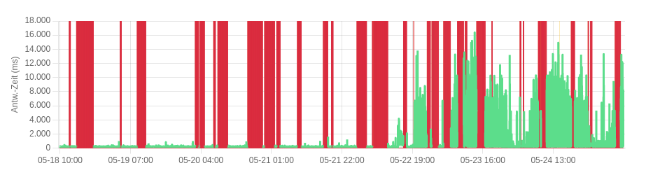

I have an issue with several docker containers that can not establish an outbound connection on a irregular, but frequent basis.
To give you an idea how often this is, here a report for a high available service monitored with Uptime Kuma:
